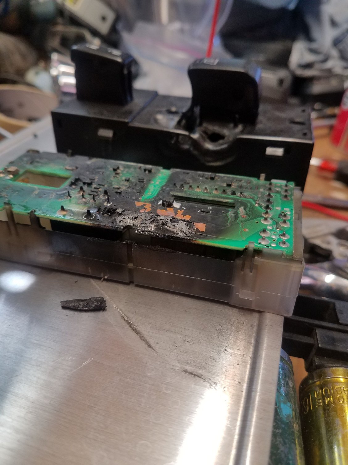

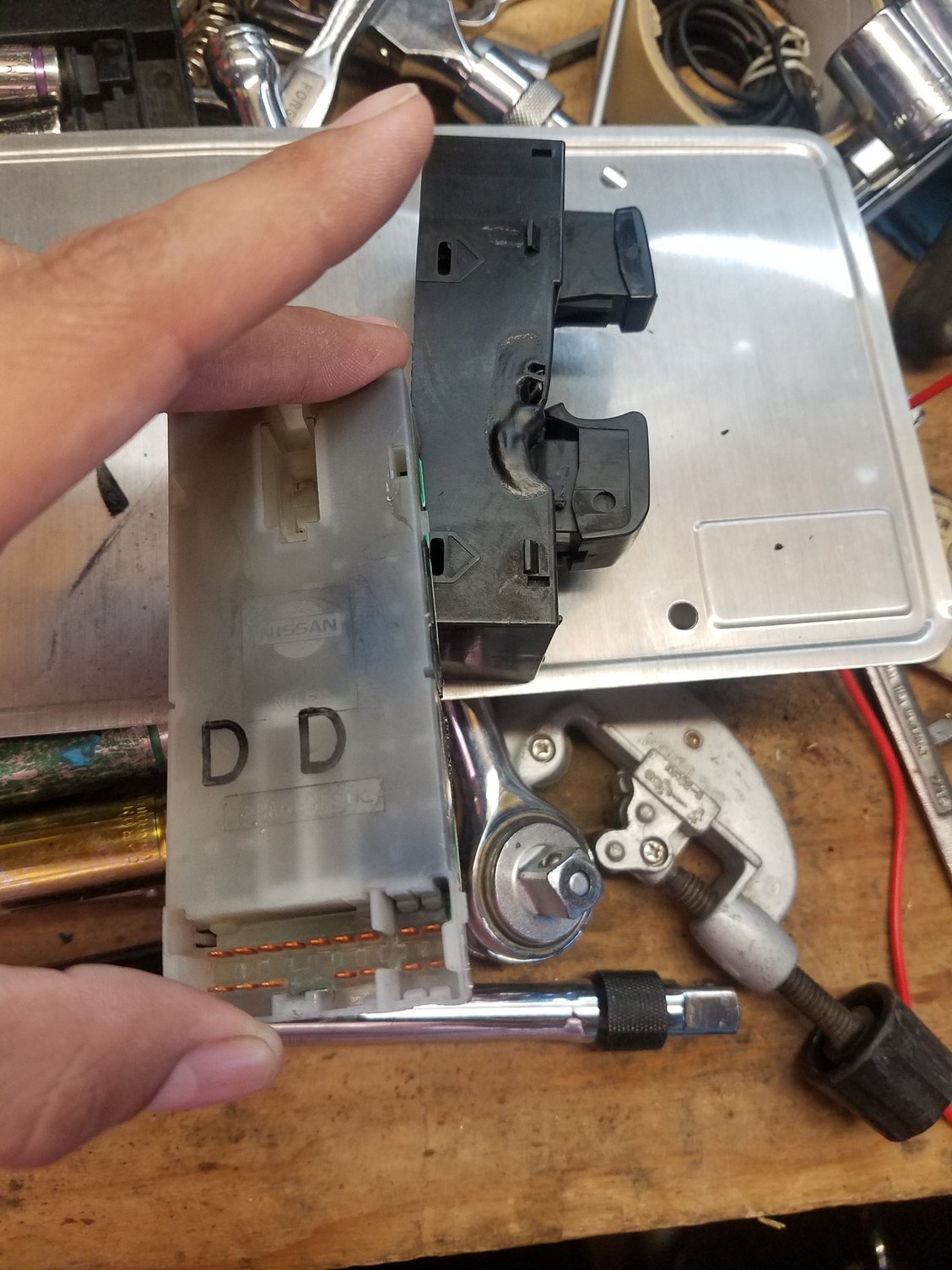

The wire harness that connects to passenger arm panel that connects to the window switch only have power going to half of the wires in the harness.
It's got stuck in the down position cause I wrapped my arm rest. No wires were melted... only the button.
The ORANGE LIGHT on window button turned off but the LOCK AND UNLOCK BUTTON still work and ORANGE light is lit.

Ouch! Thankfully your car didn't turn into a bonfire.
Where to begin.
There are no fuses for our window switches/motors.
You mentioned you replaced the motor, but I don't see where you stated that you replaced the switch assembly. The fact that you have power up until this point indicates that the switch would be the initial starting point of your problem. This would have been my first replacement since it was damaged.
I assume the reason you only have power to half of the harness is because those wires are hot once switched. If you hold the switch to the "up" or "down" position and don't have power to those other wires, then your switch is definitely part of, or, the problem.

Thanks for the advice friend (: I was planning on ordering one today since this one is toast "literally" haha Do you believe using a nissan titan, maxima or Altima window switch would plug right up to a 350z? They're exactly the same looking with look, size and connecting harness prong number #. It's because the only Z part I found was about $80 for the stupid switch but I found a 2008 nissan titan switch for $30..

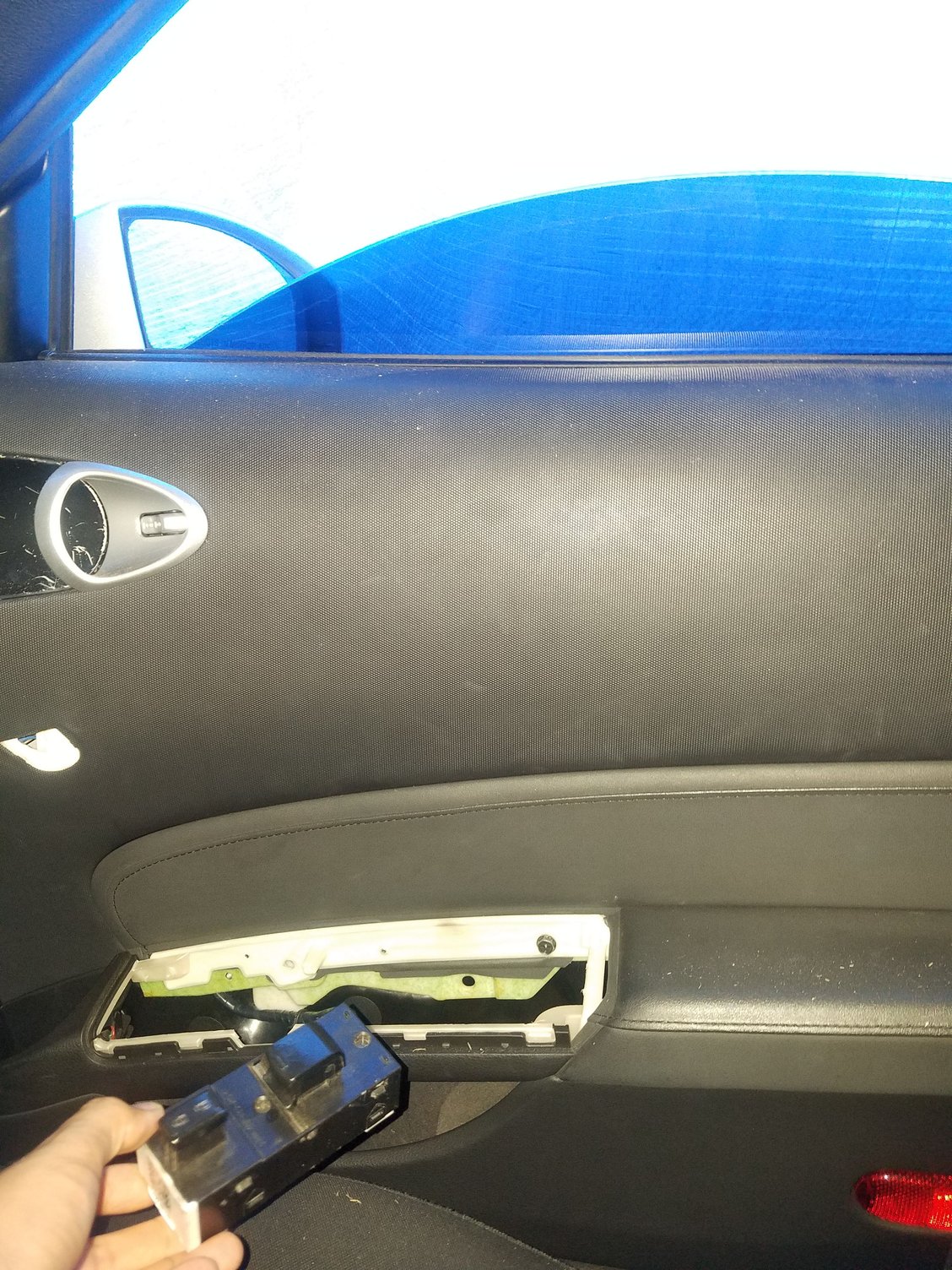

The new window switch button came in and the window rolled up......halfway. I believe this is because I need to do a window reset but my window motor did not come with a RESET BUTTON ): (Not OEM window motor) but it can also be the camber angle of the window. I believe it is adjustable but idk how to. Does anyone have a different forum that I can be directed too? Would highly appreciate it 😁😁😁😁😁😄

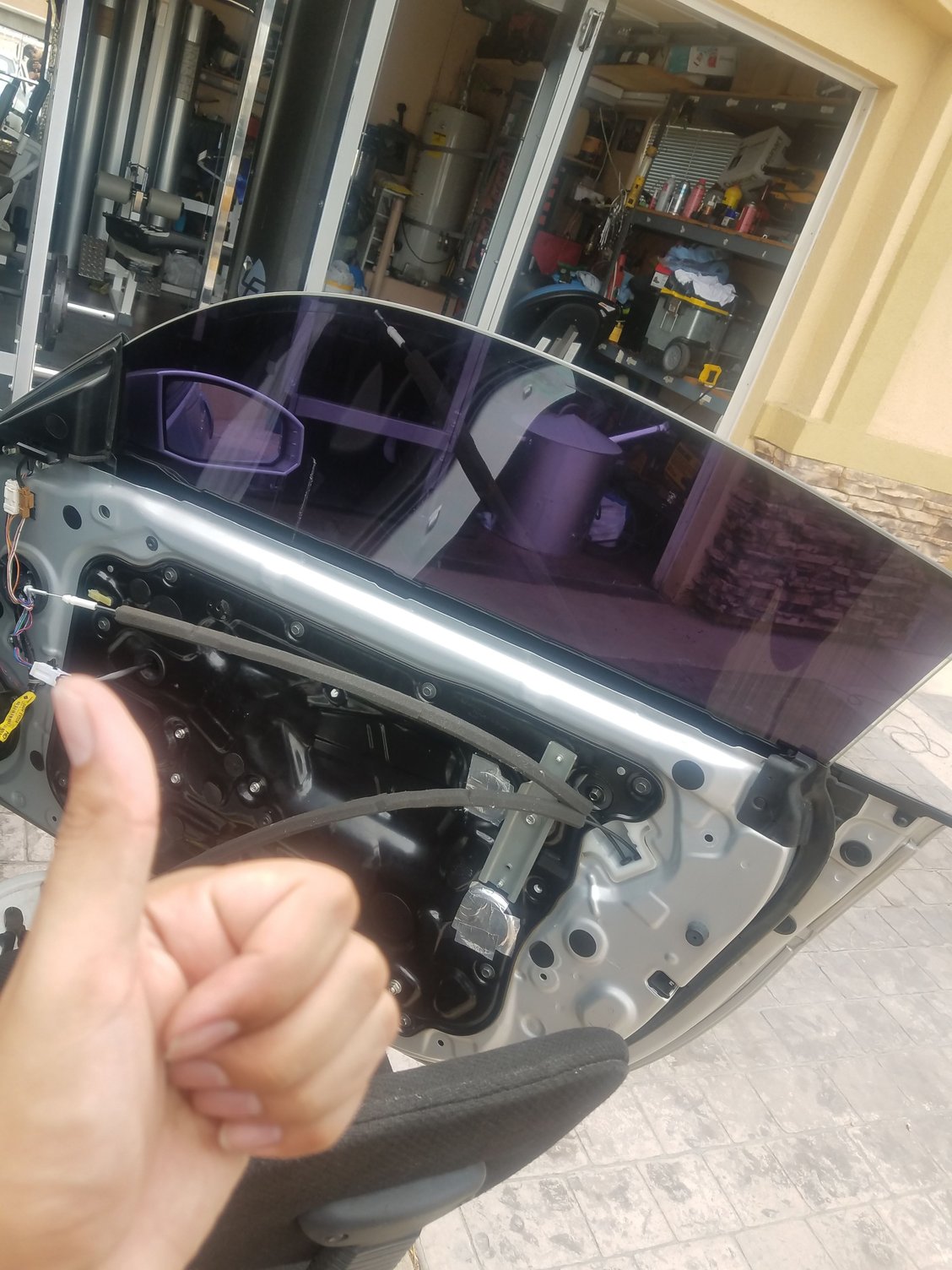

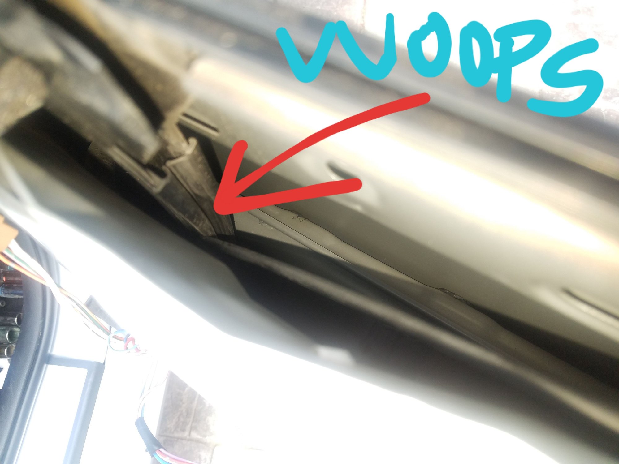

Default Success!!!!!!!! (^: I did it
I positioned the window in the incorrect spot causing it to only roll up halfway..... it needs to be in between that area with the red arrow.
After properly repositioning the window it still only went up half way.... until i closed the door while sitting inside the car. Then it went up 100% automatically (^:
The most annoying step when messing with the window..... removing the window rails.
After removing my door panel and examining my window. I noticed the window was NOT ALINED correctly in its proper placing, this happened when I installed the new window motor (As seen on 1st picture with arrows) after i noticed this i removed the black panel and window rails which is super annoying but I had too, I moved the window to sandwich in between its proper lining and bolted everything back up! .......and the window only went up half way with the button BUT!! WHEN I shut the door the window went up ALL THE WAY automatically (^: I was so happy to finally have the window go up!!
