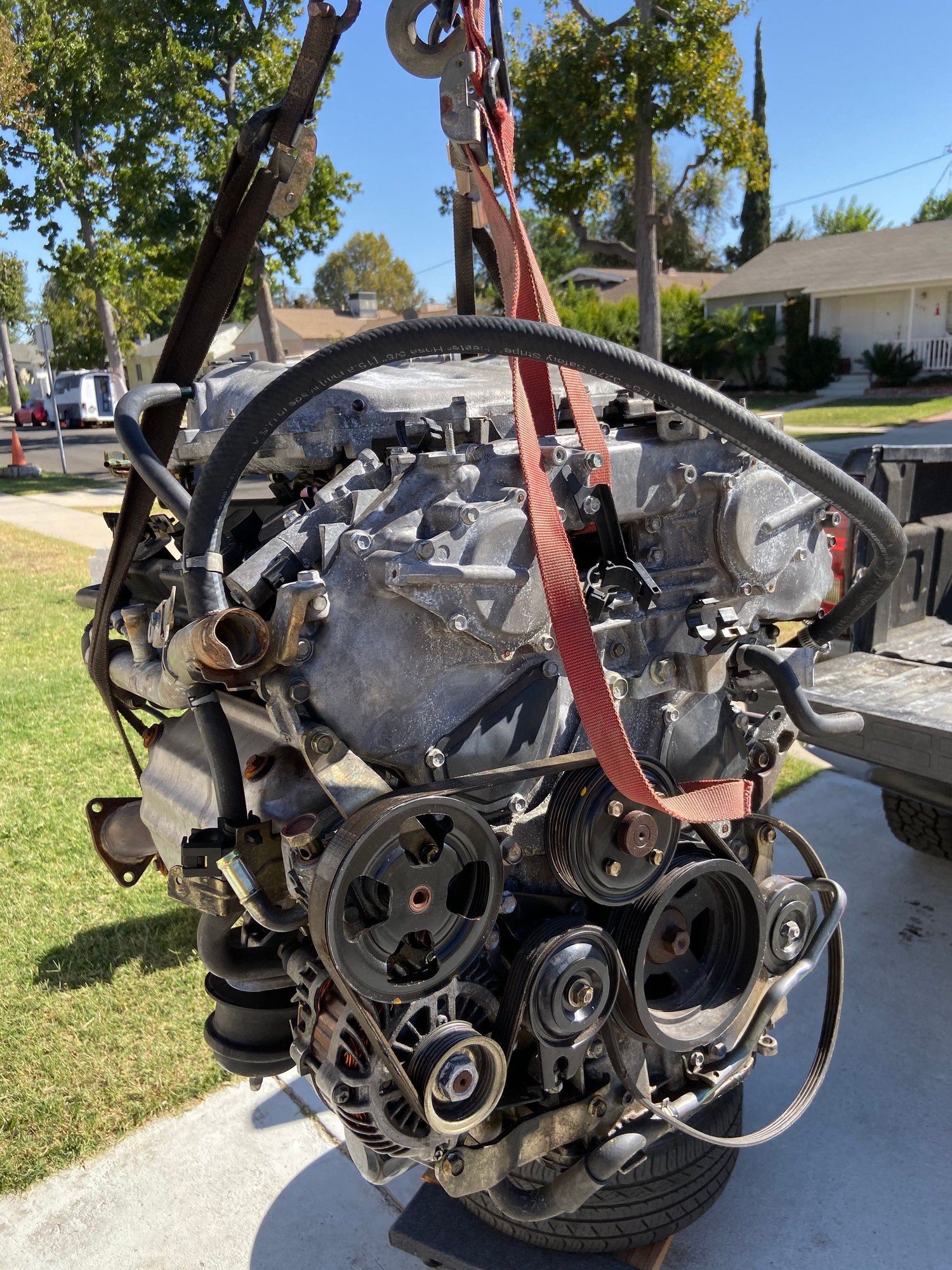

Just picked her up. 1200 cash! Looks pretty new!

That is one clean looking used motor. Hopefully it runs as well as it looks.

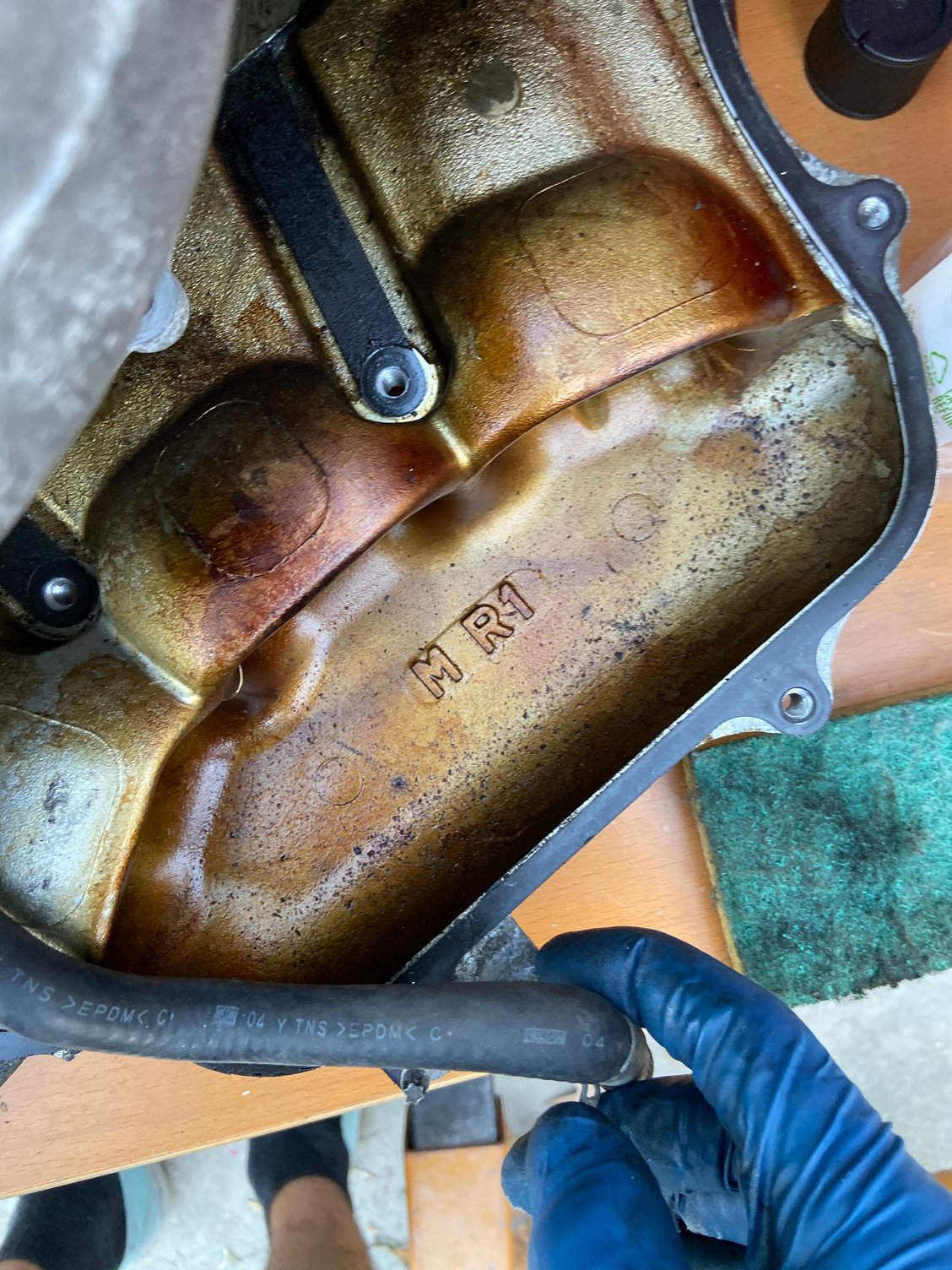

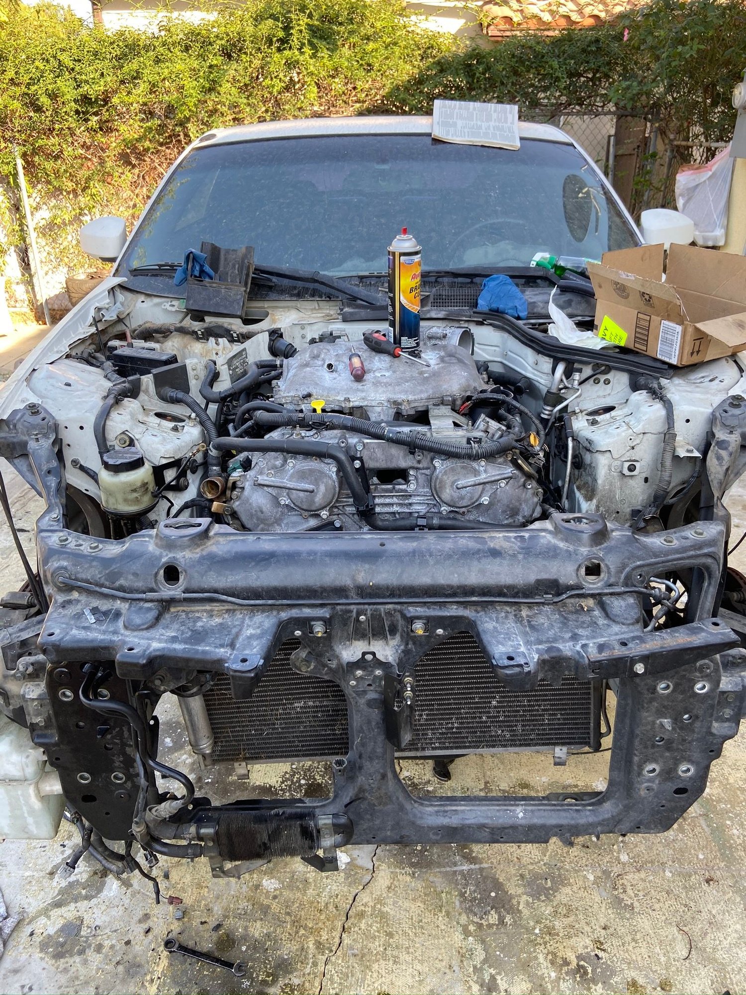

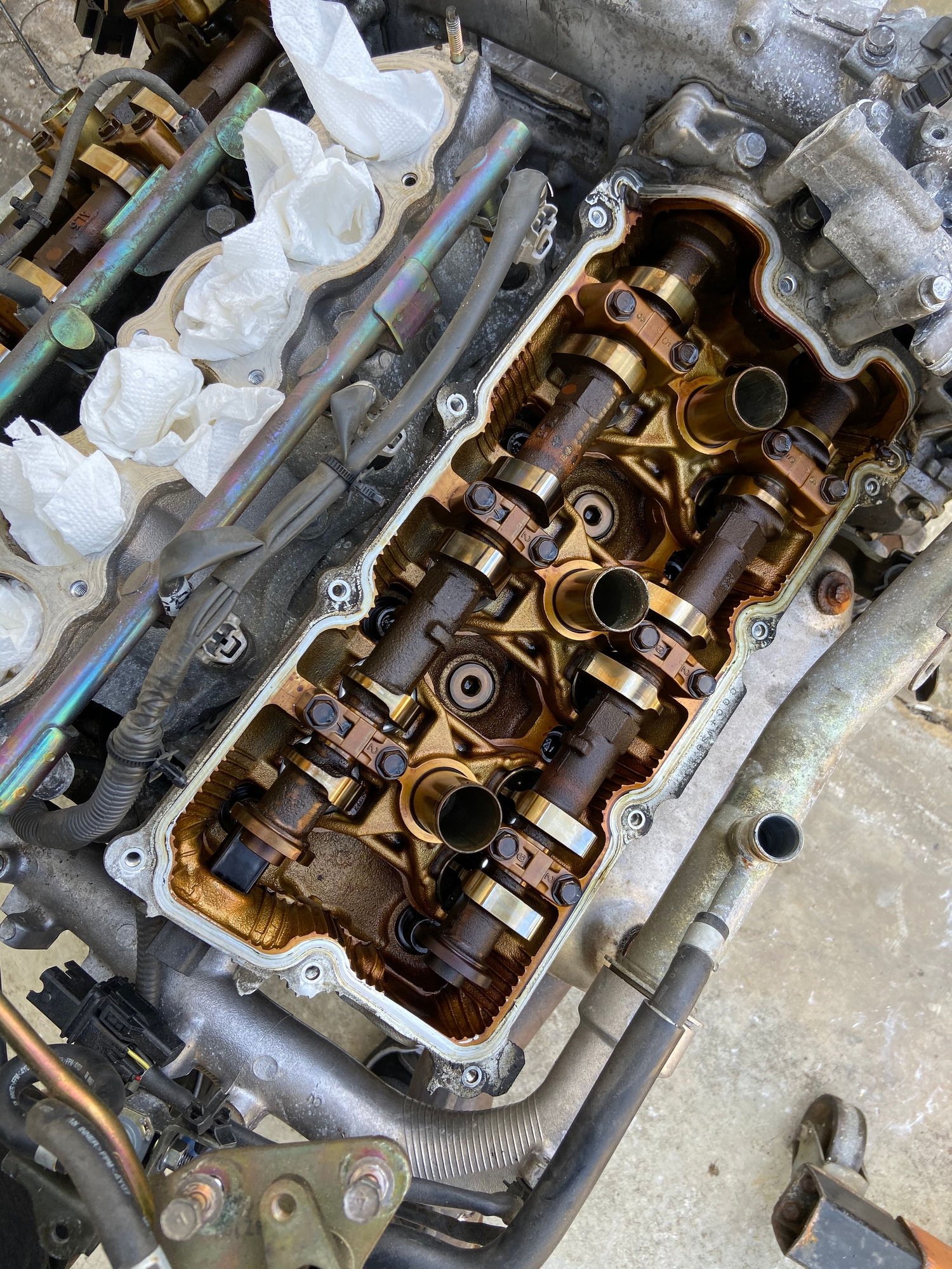

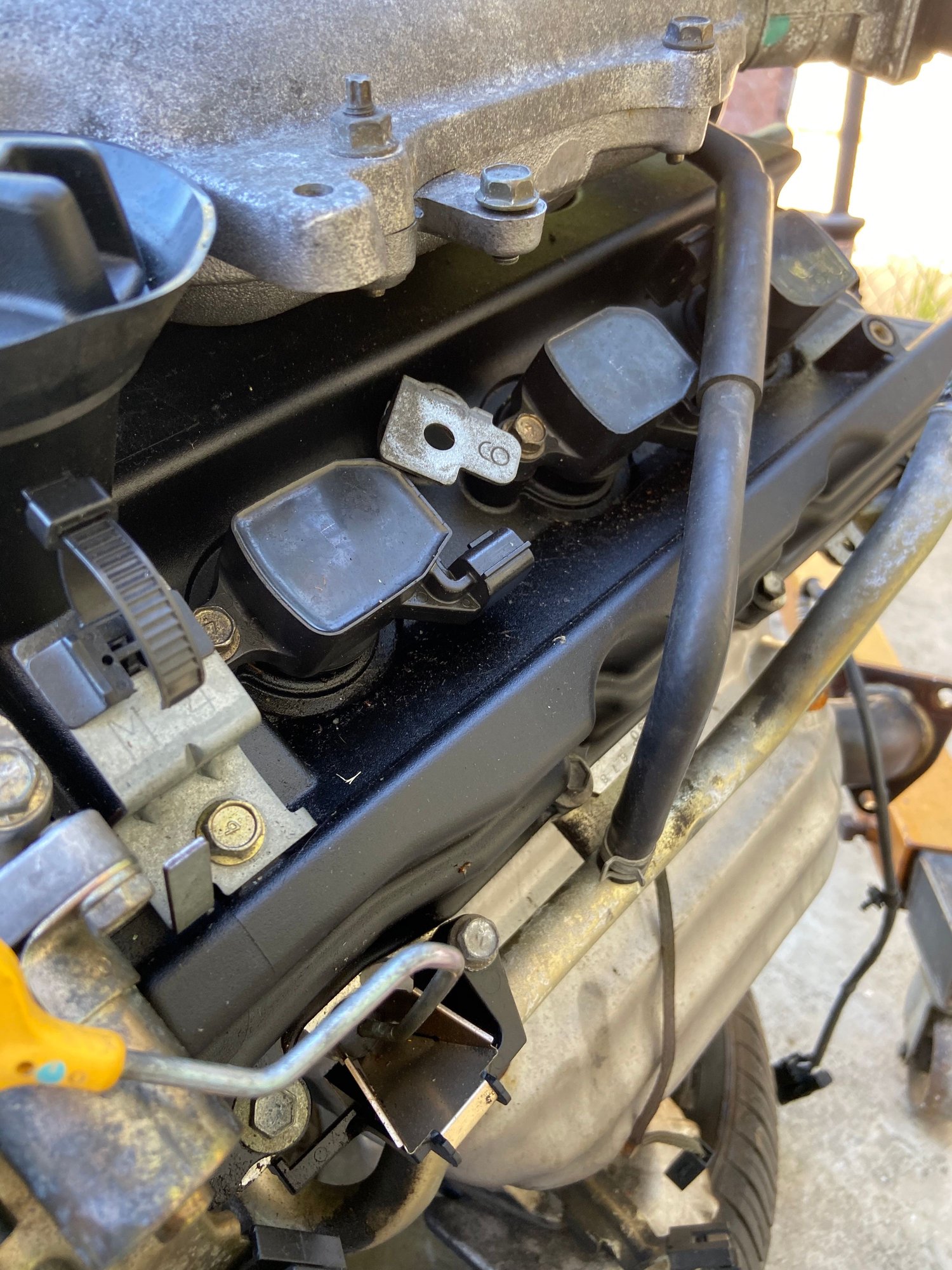

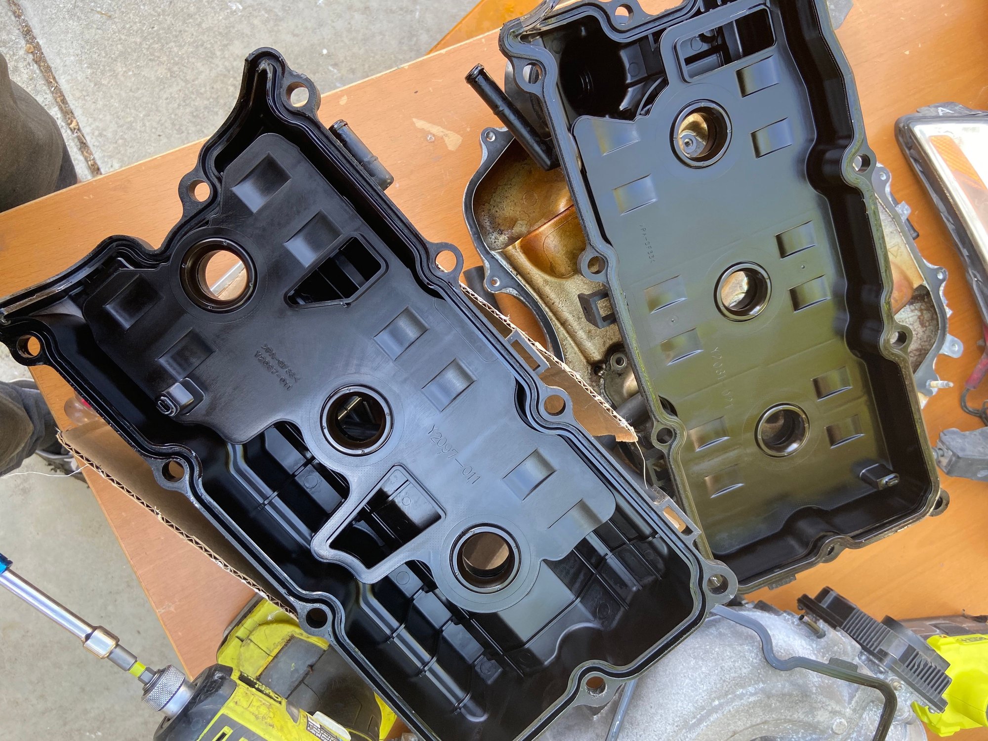

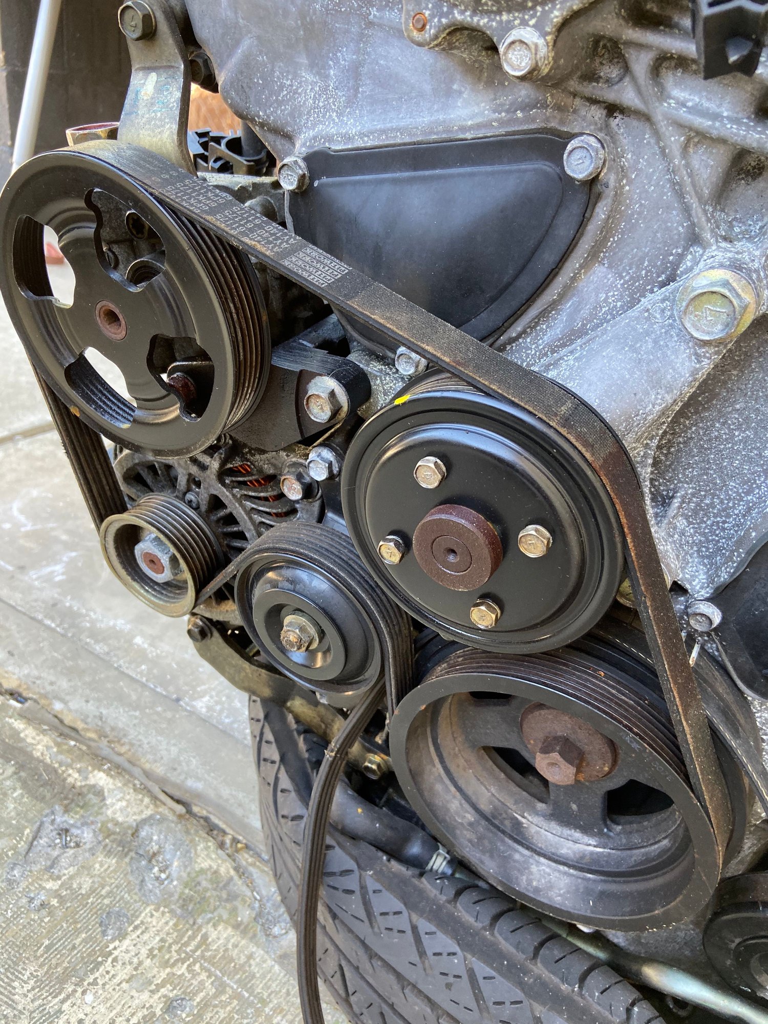

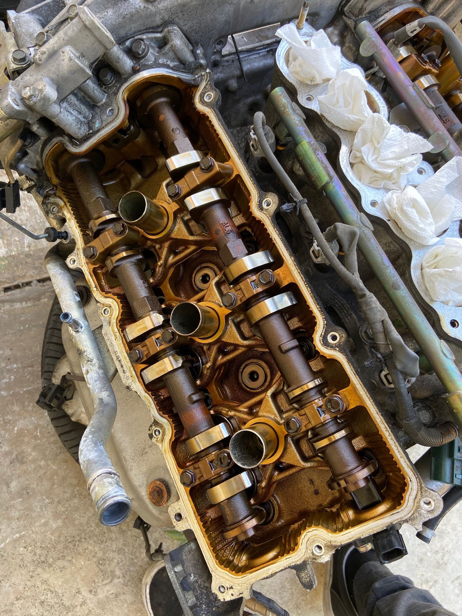

Finally got around to pulling the old engine and started to refresh the new engine today.
Everything look ok? Man these valve covers look brand new..

I'm not a VQ engine expert, but I don't see anything glaringly wrong looking at the pics.
Those valve covers must be virtually new!

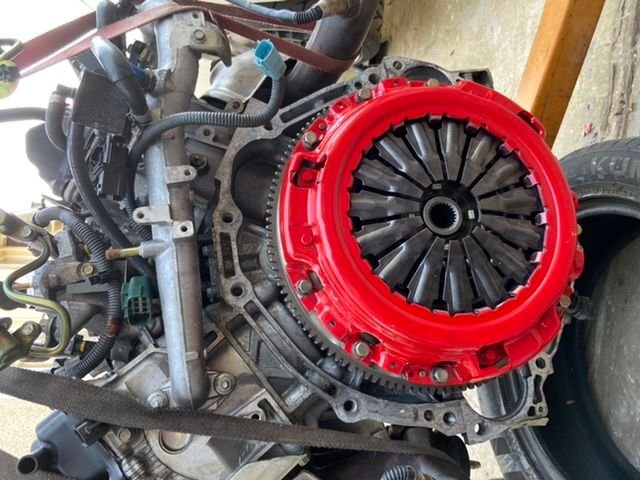

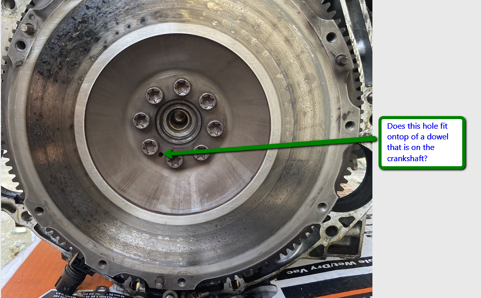

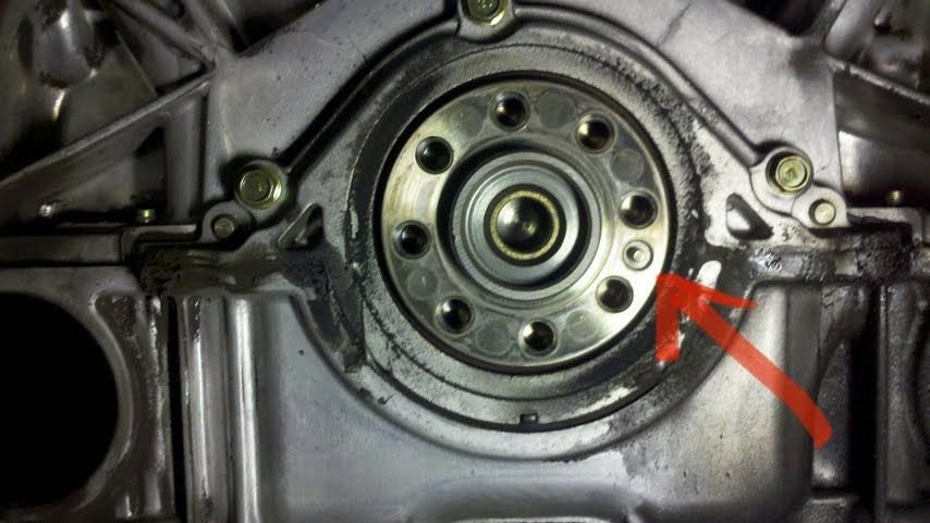

Some penetrating lube and a fat pipe extractor! Took it out no problem! Got the transmission off and found this flywheel..which isn't the stock one? It had a clutch disk and pressure plate stamped "Exedy" not sure the Nissan had exedy stamped on theirs from the factory.
Either way, ordering a new stock clutch and pressure plate now.

CMIIW... i think 350Z using exedy for stock clutch. again CMIIW

I was perusing YouTube and found that the flywheel has to be positioned correctly so that the crank shaft position sensor reads correctly and not out of wack. How is that done?

See the alignment pin?
Cool, thanks....can't figure how the YouTuber put the flywheel on wrong then....
Was it me? Cause I did that my first time. When you don't know it needs to be aligned, the dowel pins seem unimportant!

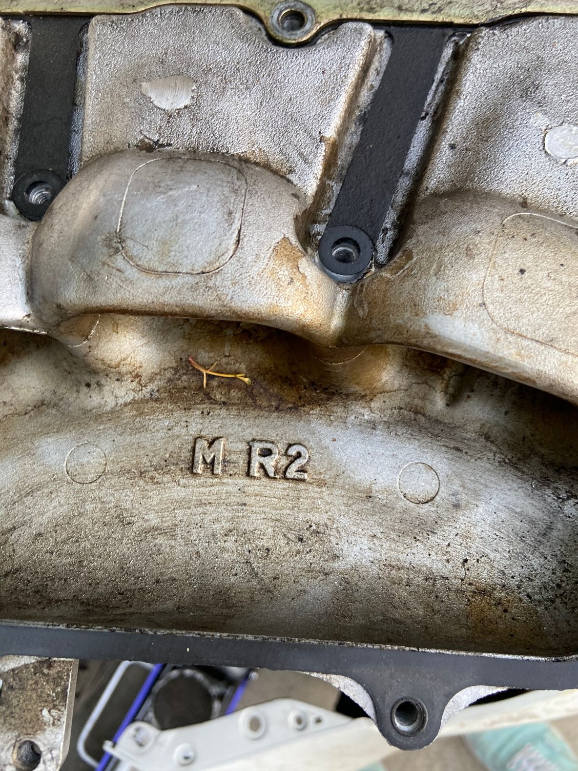

Threw a CZP basic clutch on it. Ready to get this thing back together! Also..taking a look at the plenum, i saw one is “1” and the other is “2”. Any known difference between the 2?

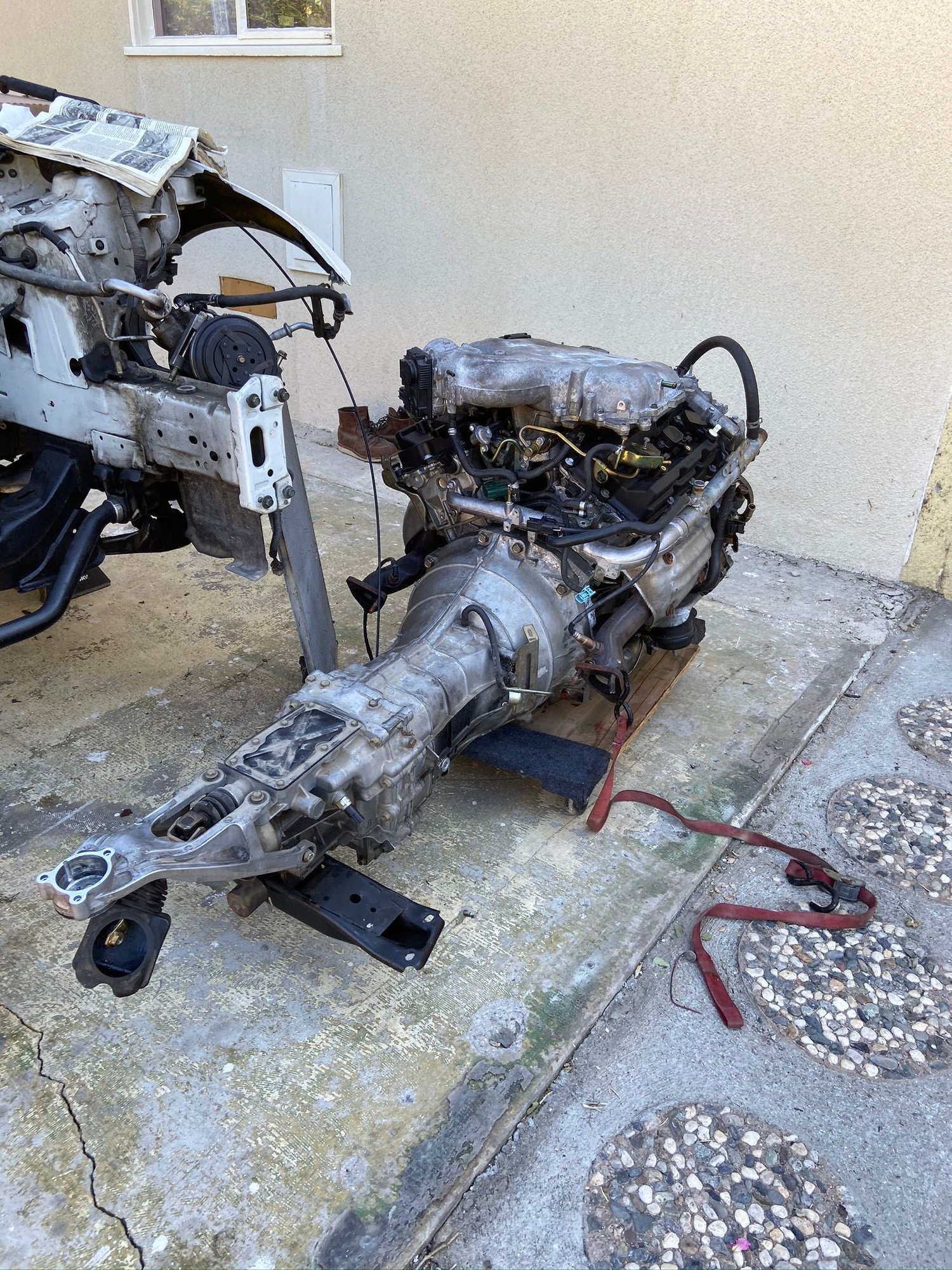

Not bad for a days work. Needed a radiator so i ordered a mishimoto for the orange Z and gonna put that stock one on here. Excited to fire!
