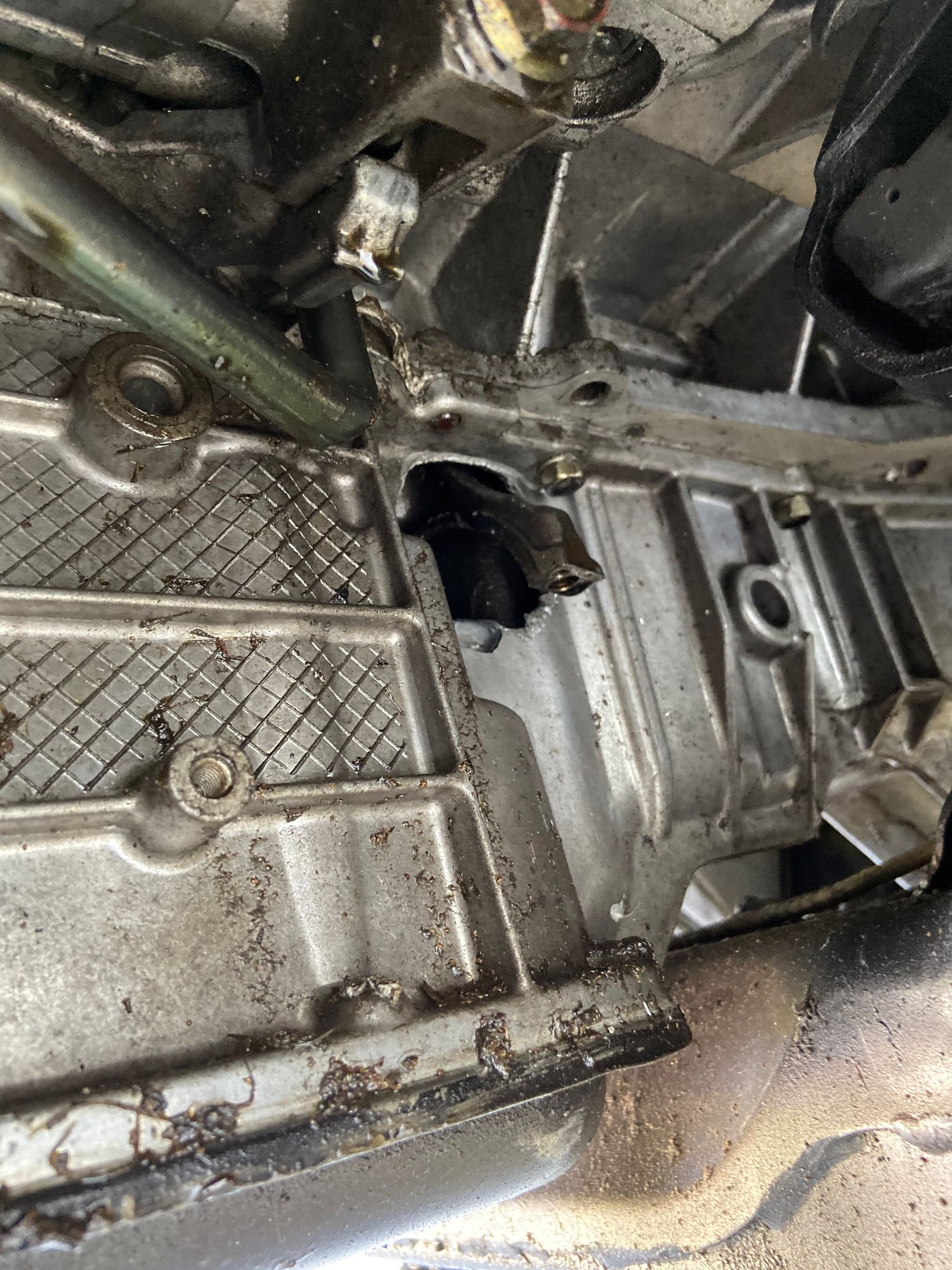

Well, I moved into a new house, tore down a sketchy "add-on" that was on the house and was left with a nice slab to move the $500 Z to. Today was the big day!
Slapped a wrench on the crank pulley bolt and it wouldn't budge. So I got down on my back to get a bit more leverage and saw this!
Calling the JDM import/engine shops tomorrow!

Not cool
ahh wait now I see why the car was $500 and why you are calling the JDM import (I thought it was to yell at them, not to order an engine)

I'm guessing he calling the JDM import for getting an engine. For $500 and another engine, still a good deal. Not like me, $3500 and still need an engine

the good news is that the likelihood that it will start when he gets the new engine is very high.
