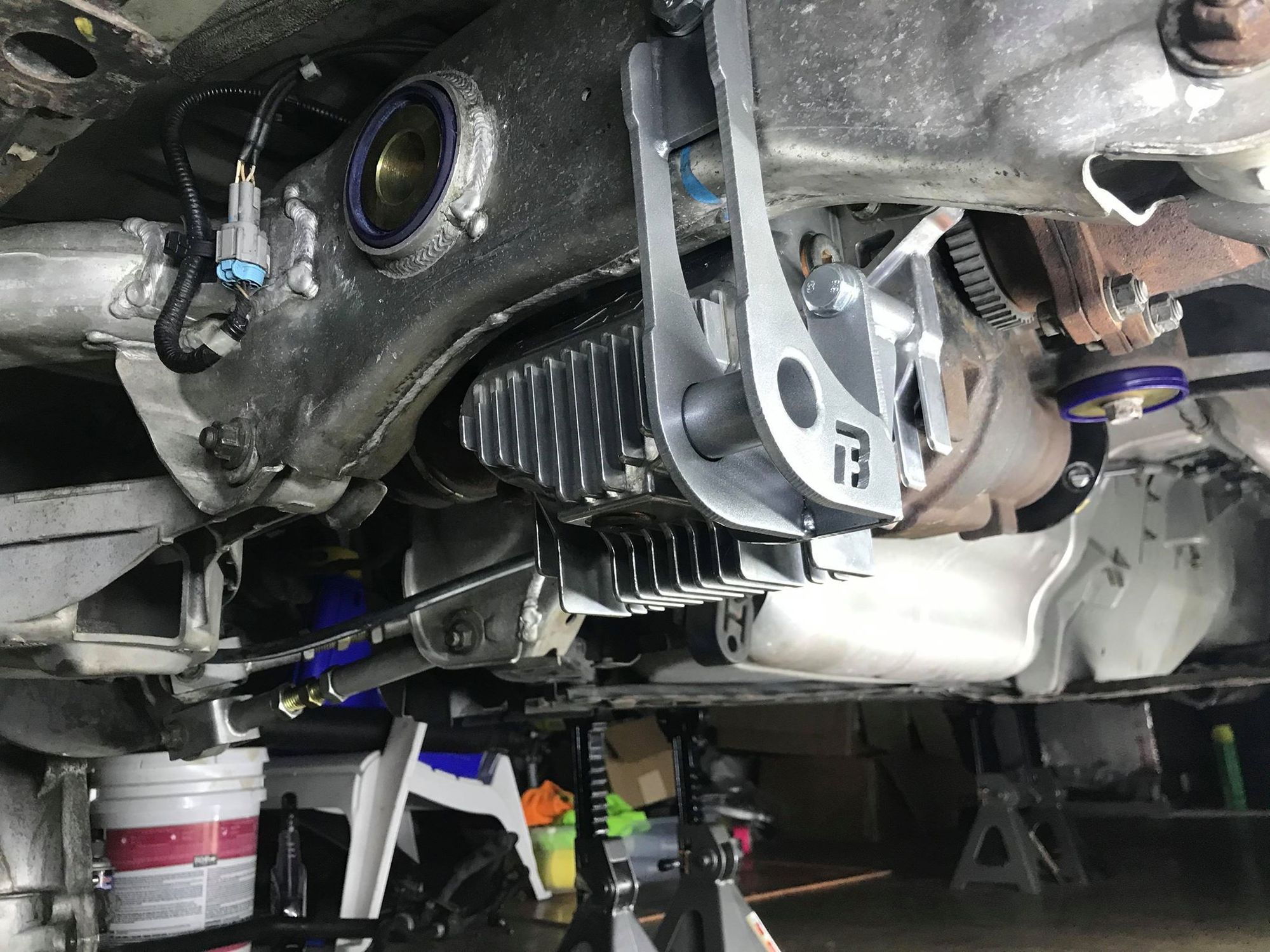

Get the OSG diff. This is a mod you WILL feel. OSGs aren't noisy like other, poorer, clutch type diffs. I've had clutch and helical. Helical is unpredictable when the rear wheels both lose grip. A clutch type is much more predictable. This is why every drift car has clutch or a welded diff.

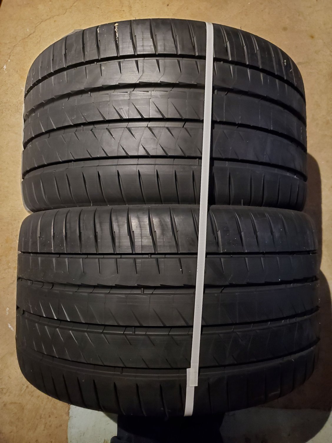

Lack of grip? Not here lol
