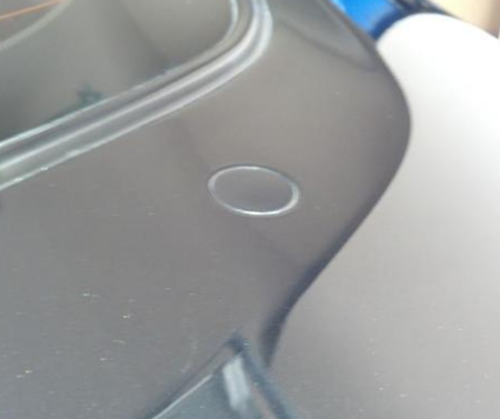

Was wondering what went into hole in top right corner of trunk?

post a picture so we can see what you are refering to please

That was for the rear wiper arm. Apparently they deleted the rear wiper like many do. Missing a plug though. There are kits sold for them.

Z1Motorsports.com has a plug kit i believe.

Jesus did the just pull it out with a set of pliers? I would defiantly coat it with some paint first to prevent rust.

Go to the hardware store and grab a sink plug. Cut off the bottom of some of the threads of the hole plug with a hacksaw. This is mine

mine was flush mount, was made by a forum member on here, it was piece of plexiglass with a plug attached to it, mounted from the bottom with 3m tape. black silicone around the outside
