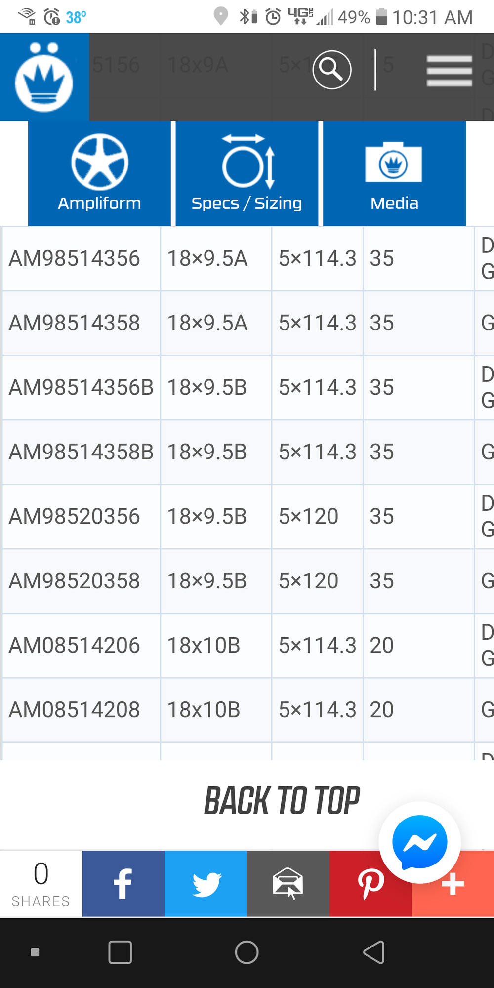

Konig has my same wheels in 17s. Originally wanted to run 18x9.5 +25 front and 18x10 +20 rear with 255/275 respectively .
They have 17x9 +25. This would obviously lighten things up a tad but I am concerned with a) how goofy this would look and b) would I be sacrificing steering feel doing this. I am 100% unwilling to give up steering feel as that is basically what keeps me from no crashing my car. I have no electronics so it's just me and the car. We need to communicate well.

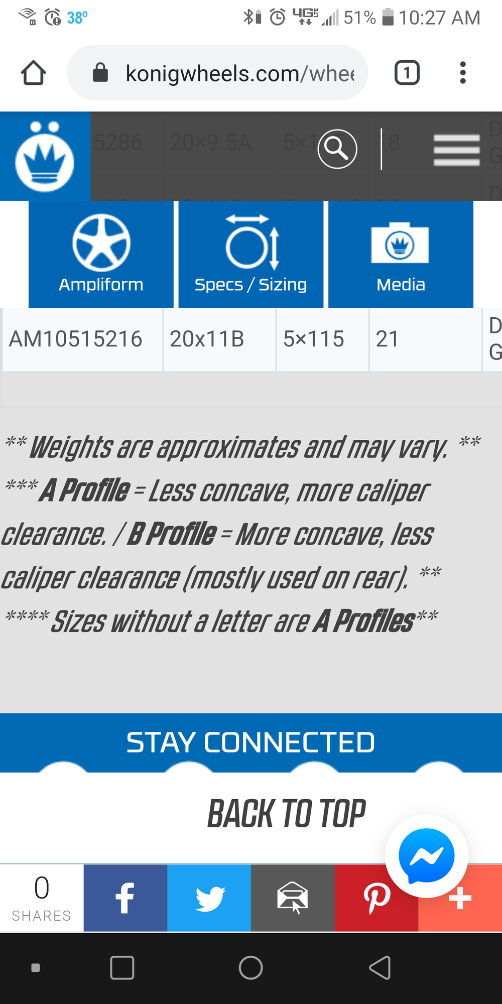

The more I think about it the more I think I should grab the 10" for the front in case I decide I want to try a square setup later. I am going to drive out to the car this weekend and test fit the rears on the front to make sure they are far enough away from the caliper. I have the regular two piston on line (non brembo) but konig has this note at the bottom of their catalog and the rears are the B type

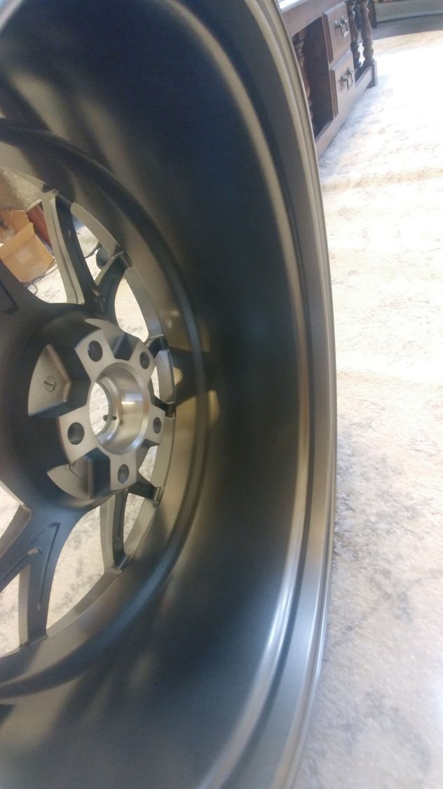

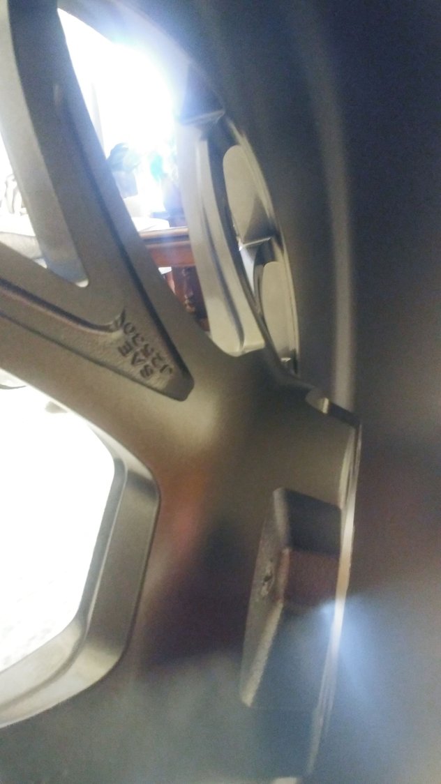

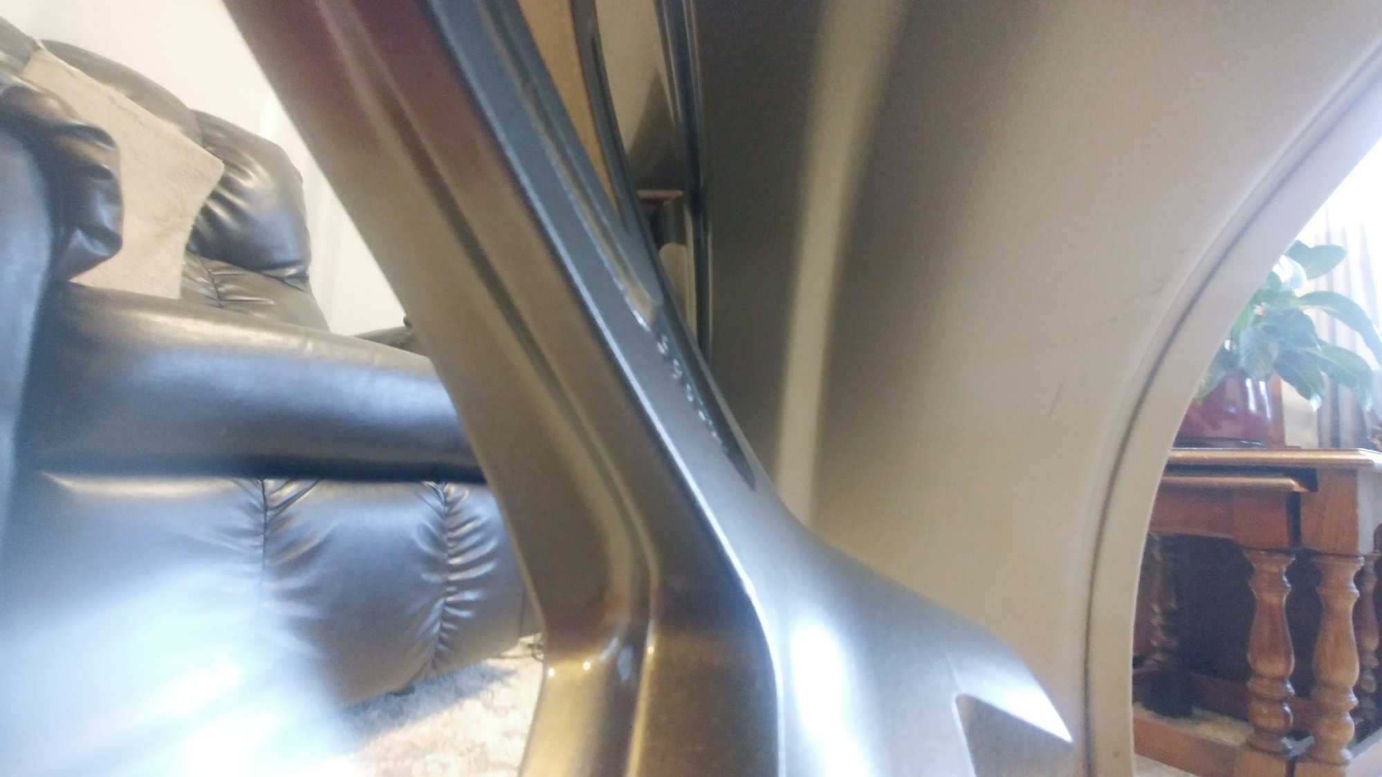

I feel like this is absolutely going to clear the front, non brembo, brakes. There is a ton of space between the inside of the top spokes to the hub.
Anybody have a tape measure and some HR brakes? Can you measure the distance between the outside of the front brakes and the face of the hub. My car is like and hour and a half away.

Take my word for it. They'll fit. Almost ANY wheel will fit the standard brake setup.
Old Mar 2, 2020 | 02:43 PM
Bmsluite's Avatar
Bmsluite
5 Year Member
Joined: Oct 2019
Posts: 462
Likes: 36
From: Chicago
OK, I will take your word. I have never even actually considered this with wheels before. Everything always just fit. Figured I would ask just in case. You just saved me 3 hours of driving
