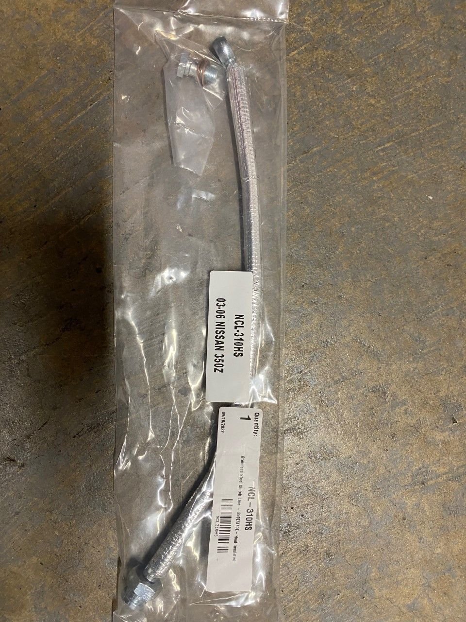

Went to install a stainless insulated clutch hose from Z1 - total fail.
Got my *** kicked trying to remove the old line.
The usual impossible angle with no room to work... can't really see.
Amazingly I got the "worse" end. The "easier" end with better access just won't let go.
Started to twist the hard line and don't want to get in trouble there.
I even let it sit overnight coated in PB blaster.
Other problem is the line from Z1 is wrong and they won't believe it.
Clearly marked 03-06 and they are claiming it's the same for 07-08.... ummm No.
03-06 has a banjo fitting... 07+ has the compression brake line clip thing (tech term) on both ends.
I'm considering just buttoning everything back up and sticking with the stock line.
I had some clutch fade and cooked the fluid on the track, but that was just Dot3.
Swapped to 5.1 and maybe that will be enough of a difference.
Even if I get the correct hose, I think I'm going to need a new hardline to the transmission and so far I'm not finding that very easily.

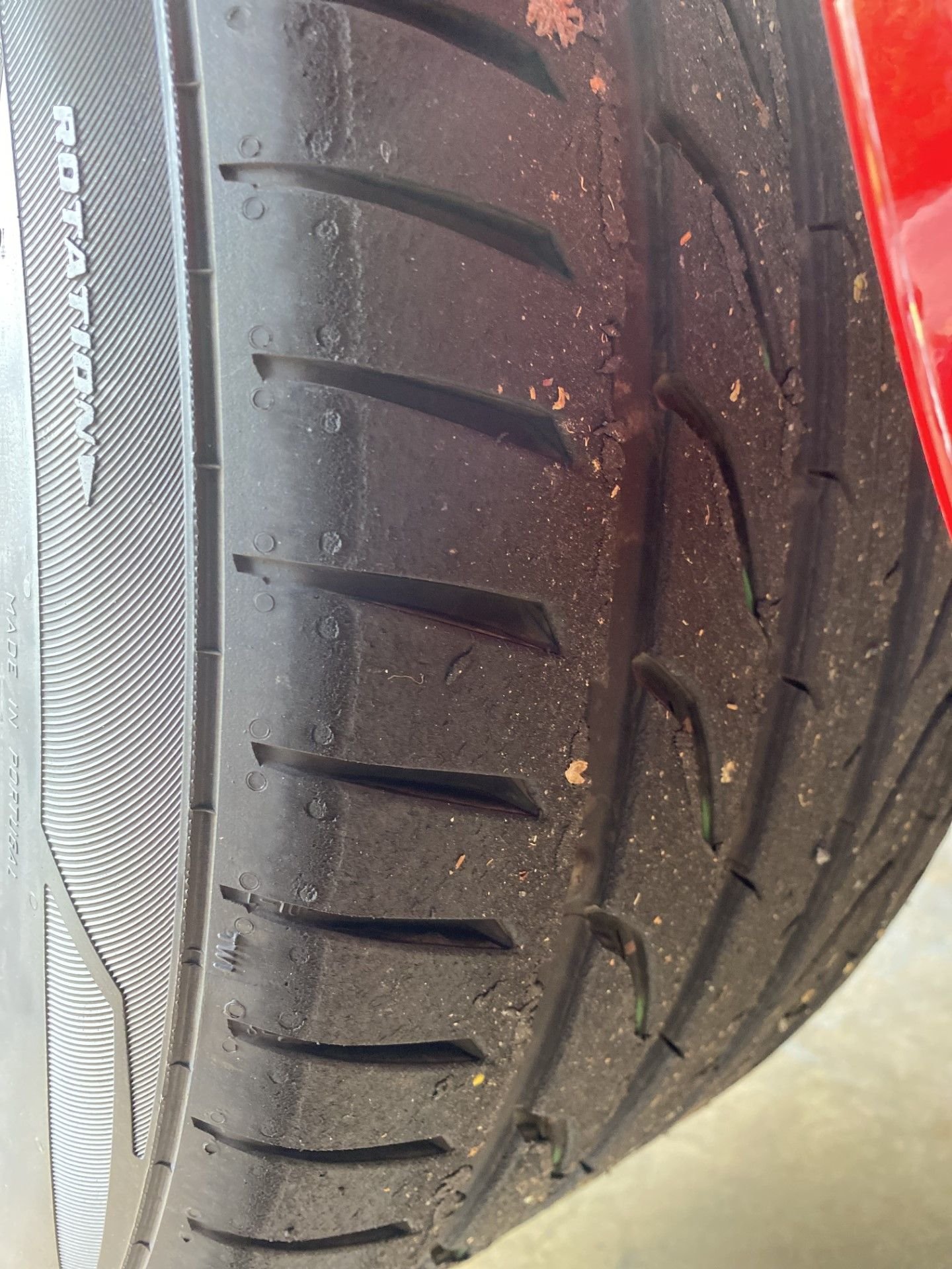

Tried to pay attention to tire temps, pressures and wear pattern (based on internet education only) and I think I got things close.
Here is a picture of the tread - obviously some wear, but looks okay... I think?
Maybe a bit too high of pressure... wear not quite to edge of sidewall and a little excessive center wear?

Inflation pressures with street tires are difficult to get right. Your tire blocks are beginning to shred around the edges and rollover around the edges indicate you were slightly overinflated. But you don't want to go too far with good street tires that will begin to chunk in bigger sections. If you continue to enjoy this, it's time to consider a set of dedicated track wheels/tires to keep from tearing up a perfectly good set of street tires. But depending on finances, getting a separate Z33 coupe for track use may be a better option...

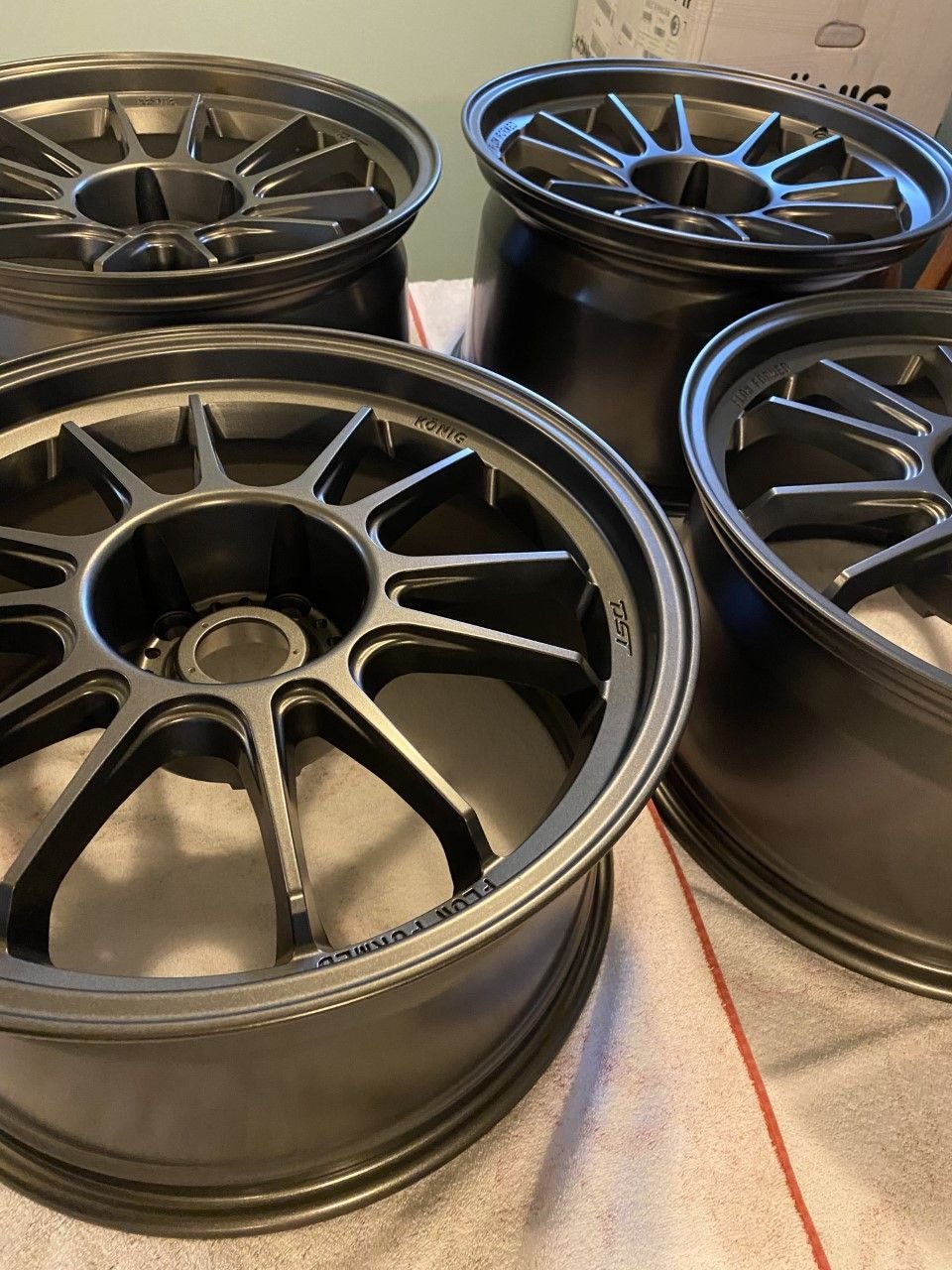

I went ahead and ordered wheels... went with Konig Hypergrams 9.5 and 10.5.
Probably go with the Kumho Ecsta V730 tires in the spring.

Default New Wheels & Tires
Finally got tires and had them mounted.
After going back and forth went with General G-Max RS.
Had the Michelin Pilot Super Sports in the Tire Rack shopping cart, but the Generals were $750 vs $1300 so I figured why not.
The darker wheels certainly change the look.
I don't dislike the new wheels, but being an old guy would probably give the nod to the chrome for looks.
Old setup in front was 225/40 and the new 255/40 is about a pound lighter each wheel/tire - 45 lbs now vs 46 lbs.
Rears even more of a change from 49 lbs 245/40 to 46.5 with the new 275/40 setup.
So far I like the tires.
First track day is 11 May, so we will see how they do then.

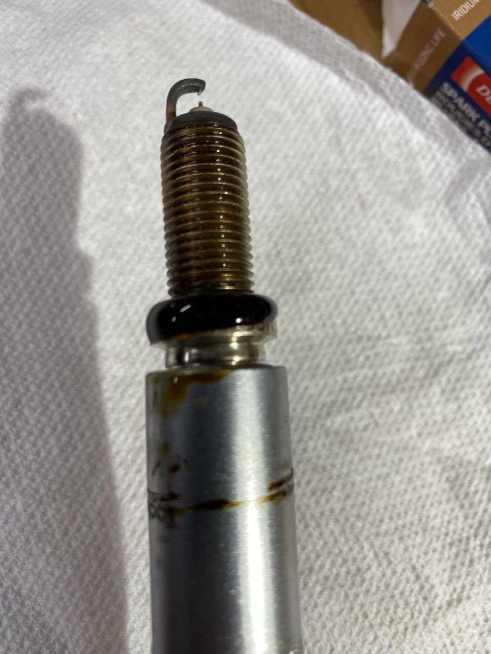

Default Oil on Plugs - Valve Cover Questions
So I finally installed the plugs i've had sitting around forever.
Drivers side seemed okay... little dirtier than I expected but 113k and I'm guessing original plugs?
Passenger side had oil on 1 & 5... crap.
I dutifully did all my searching and it seems that I need spark plug seals which also equals valve covers unless I want to start doing hole saw/RTV mods.
For me the labor is worth new parts so I will probably try and tackle my first real repair.
Questions.
Q1 - Once I get this all taken apart, think I should I just do BOTH valve covers? Assuming I go with Z1 its $301 for the first... $289 for a second.
I'm figuring as a YouTube mechanic this is going to be 50 hours of labor anyway.
Q2 - What else should I be thinking of doing?
Car has been running fine, no codes... any "just in case part" I should replace since I'm already this far?
Q3 - since the car is running fine how urgent do you think this is?
I'd never have known if I just left it alone, so I'm thinking it can wait a few weeks/months.
Old May 1, 2023 | 04:59 AM
Heel Til I Die's Avatar
Heel Til I Die
Joined: Apr 2013
Posts: 3,857
Likes: 1,305
From: Raleigh, NC
If I were you, I would just do both valve covers at the same time. You'll already have just about everything off in order to tackle the passenger side. The P/S is a little harder than the driver's side thanks to the not-so-easy-to-reach rear bolts. Also, since the spark plug tube seals are failing on that side, it's probably only a matter of time for the driver's side.
For a little extra insurance, I would put a bead of RTV on the replacement tube seals before installing. Not absolutely necessary, but it will likely extend the life of the new seals.
Don't get the plugs mixed up for the coil packs when reinstalling!

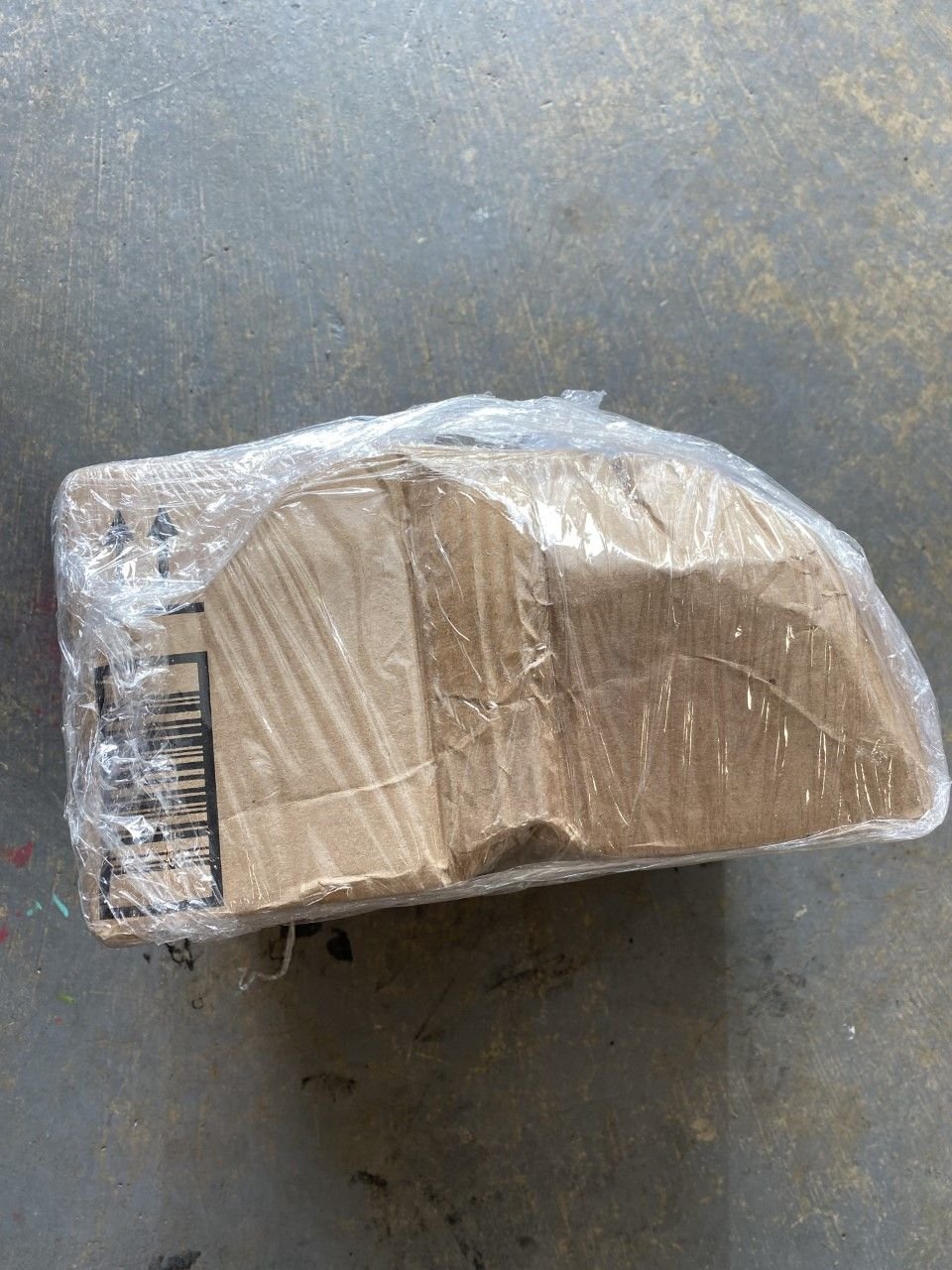

Default Eugene Turkov / Enthusiast Auto Care - ECU Repair
Realized I screwed up the idle after pulling apart the throttle bodies etc.
Could NOT get it to re-learn after dozens of attempts.
After some research, I guess the 2007s and maybe more years have an ECU flaw... dealers just want to sell you a new ECU.
Found a place in Germany, a place in England and thankfully Ethusiast Auto Care in California that said they can repair.
Pulled the ECU and sent it off for a firmware update.
Regrettably, I missed my first track day.
Had a brief scare as the return shipment got lost for a few days by the post office (not Eugene's fault, he had sent me pix of he box when he mailed it).
Then this smashed damp box wrapped in plastic wrap arrived today.
Thankfully everything worked just fine after getting it installed.
Idle Air Relearn took on the first try.
Eugene was responsive and great to deal with - give him a call if you need help

Default Tire Pressure Advice
Did another track day on the new tires - General G-Max - not true track tires, but what I got.
76 degrees and hazy, 4 sessions of 15-20 mins.
I was 32-33 lbs cold and 37-38 when hot both front and back.
Fronts wore right to TWI (like the triangle) so I'm thinking i got the pressure right?
Rears were almost 1/2 inch short, so I'm guessing too high a pressure which makes sense after further research ... 3-4-5 lbs less in rear seems common for front engine, rear wheel drive.
Any comments on these pictures?
Anything else I am messing up? Tires doing fine? Tires suck and falling apart?
I really don't know what I am looking at... Do the gummy lines of rubber on some of the edges mean anything?
Rear Tires (look the same)
Passenger
Driver
Old Jun 9, 2023 | 03:46 PM
  #39
dkmura's Avatar
dkmura
General & DIY Moderator
iTrader: (64)
Posts: 8,631
Likes: 1,396
From: Aurora, Colorado
Looking at those pics remind me of exactly why it's not good to use new street tires at a race track. The General G-Max rears show little wear b/c they are not as stressed as the fronts. Running full tread tire blocks will usually result it the shreading and distortion that your fronts display. Essentially, the severe understeer that you experienced overheated the outside of the front tires and destroyed them. Hard to tell from the photos whether the inflation pressures were in the right range as the rollover on the sidewalls can't be seen.
Was the track day at Summit Point or VIR?
Old Jun 9, 2023 | 04:09 PM
  #40
Unretired's Avatar
Unretired
Joined: Jun 2021
Posts: 61
Likes: 20
From: VA
Thanks fro the reply.
It was a SCCA Track Night in America event at Dominion Raceway near Fredericksburg.
Rears were under I think - General has a TWI instead of the triangle you can see in this picture.
Fronts were almost right
Noisy understeer sounds like what I experienced.
So you are saying I went from destroying All Season Continentals to destroying Summer Generals... maybe I just learn slow.
Are these unsafe - Don't use them again? Or will I just get progressively worse understeer.
The other tire I was considering was the standard Michelin Pilot Super Sport... is that still too street?
I'm only doing 4 maybe 5 events a year... didn't really think it was too crazy but I am running hard when there.
I thought i didn't need true track tires for such limited use.
