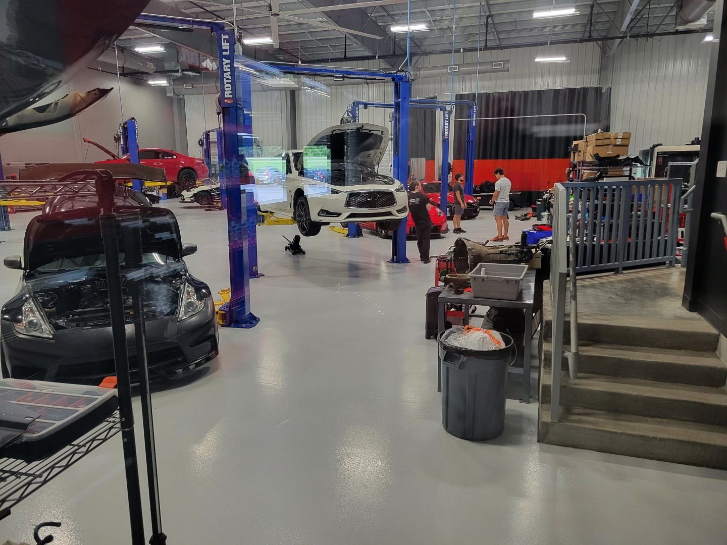

My friend Austin and I drove four hours down to Z1 Motorsports in Carrolton GA today to get the initial dyno done on my 2006 350Z Roadster Touring with 23K miles. I'm planning to make some mild bolt-on mods to my car, and I wanted to know the baseline before doing the mods. The car was completely stock for this test. I even traded out the K&N air filter I had installed for a new one from a parts store.
On the way down, we each made a guess as to what we thought the HP would be. Austin guessed 262hp and I guessed 252hp.
Z1 Motorsports has a great new facility. This is a first class operation and I'm very glad to be within reasonable driving distance. They have some very cool cars in the lobby. The workshop is immaculate and they have eight lift stations. Everyone there was very nice and helpful. The guys operating the dyno seemed to really know their stuff. We waited in the guest lounge where we could sit and watch the dyno testing through glass windows.
My car made 252hp. While the test was going on, the operator seemed quite impressed, giving us the thumbs up and telling us that it was very strong.
