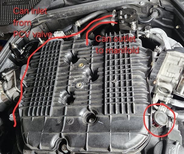

Can confirm Icer's advice as that's the setup I'm running on my HR. I have a small crankcase filter on the driver's side outlet where it used to connect to the factory intake hose, and a non-vented catch can connected to the PCV valve. The catch can outlet is connected to the stock port on the back of my intake manifold. Full disclosure, I'm not sure if this is even the optimal setup since this is my first oil catch can, but it seems to be working okay for my boosted Z. Excuse the filthy engine bay, but here's a quick mock-up.
that is a boost leak waiting to happen, and it's not a good way to route it.
What exactly is the boost leak waiting for? I also don't have any "oil misting everywhere" from my breather. How would you recommend routing the catch can(s)?
ok, so if this is the way you have it, every time you hit boost, EVERYTHING outlined in yellow is getting pressurized with whatever psi you are running. This is also, forcing the PCV valve closed when it shouldn't be.
