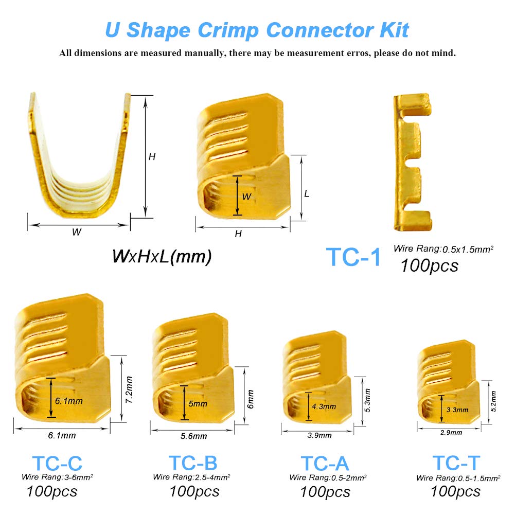

If you are going to crimp them yourself, make sure you use some good quality connectors like this. Do not solder them. Repining them would be your best bet but if you use quality connectors and not those autozone crappy connectors you should be good.
Alrighty will do! First im going to try and see if anyone can repin it for me without charging an arm and a leg and if not then ill just use these
