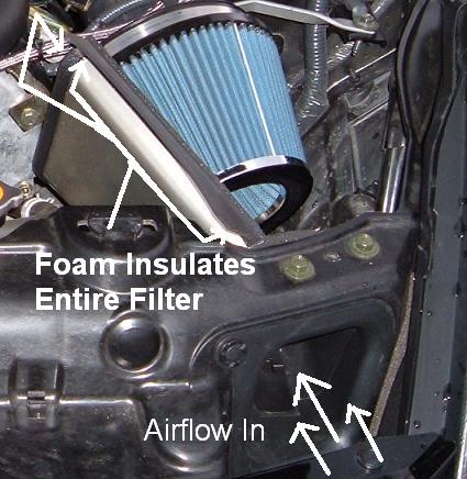

My vote goes with the short ram setup with a good heat shield (as the pop charger provides). Two reasons:
1 - The longer the intake stack, the less efficient airflow becomes. Yes, you get colder air, but not much colder than a well tuned short ram can provide. Think of it as breathing through a snorkel thats 1 foot long, compared to breathing through the same snorkel that is now 3 feet long (and I have done both in real life lol)
2 - The factory setup provides somewhat of a ram air setup. Locating an intake system just behind the air inlet provides cool air, and the heat shield provided by JWT works wonders. You can actually touch one side of it, and feel the difference in temp on the other side. The intake stays cool to the touch at all times, and I have ran this thing in 80F plus ambient temperature.
What it looks like installed:
Attached Thumbnails Cheapest Reliable place to get a JWT Popcharger-shortrampluses.jpg
