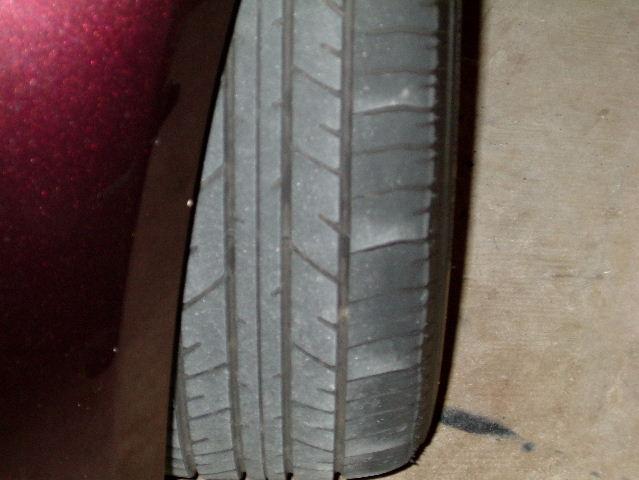

First off I want to thank everyone who made an effort to be heard for the feathering problem. I have a 350z 2004 built on ~june. I just got 15000 miles on my car an stated noticing some feathering on my front tires. I took it today to the best service dealer in miami for maintenance. I just mentioned i had a tire problem, and they already knew about the feathering issue, so they told me they were going to take a look... Two hours later the car was done, and i was told the tires were going to be replaced for free. They ordered the tires, and are getting installed on wednessday or before depending on the day they arrive.

ill ask for the alignment once i get them on, whenever they arrive, probably wednessday... Yeah my car was buil june 2003, and i bought it on september, aready 15000 miles ... but still running like it was ment to be, anxious to have the new tires though and feel the smoothness again... For what is feathering: is when your front tires get weared (and looked kind of in a steeper slope) in the iner part of the tire, the part facing the vehicle. For more info i sugest doing a quick search on "feathering".

pic

Originally posted by overlord tom
Exactly what I was thinking. Made in June 2003 it has to be a 2003. I have yet to read a single post from anyone with a January 2004 or later build having the tire feathering problem.
It's a 2003.
(hint, hint -- The picture is of a Brickyard)

Originally posted by marhot
It's a 2003.
The brickyard picture is not his. Check his profile, he lists a Daytona Blue as his color just like his avatar shows. I still think it's a 2003 though.
I stand corrected.
I assumed the tire feathering pic was his tire feathering.
