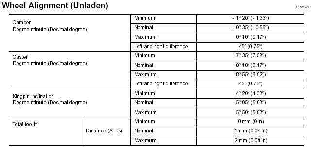

Mannish boy: thanks for the chart.
Is it just me? Am I old fashioned, or do the toe-in amounts seem to be stupid-small?
If the mechanics aren't following this 1mm recommendation (the width of a paper-clip) and are doing something more traditional (???), like 1/4, 1/2 inch, then?
Has anybody checked their toe-in themselves to see what it is at? If all the people who are having problems are like at 10mm, and all the ones not having problems are at 1-2mm, then it seems the answer is easy....

My question is how many degrees in an inch ? Anybody have such data on their fingertips?
Sorry for the inoperative link, had an extra http in there. The address is valid:
http://www.kimmeltire.com/html/tire2.html

Originally posted by Boomer
I just reread your post on toe-in 1/3" out of alignment. Using Mannish Boy's chart saying 1 degree is nominal makes your toe-in WAY out. I forgot to ask my SW how out of spec my tires were. When I asked him at my next visit, he just said the tech feeds in the rec's for changes from Nissan into their alignment machine and it does it almost automatically. I assume your dealer has similar alignment equipment, but I don't know for sure. BrianZ alluded to the discrepancy earlier.
