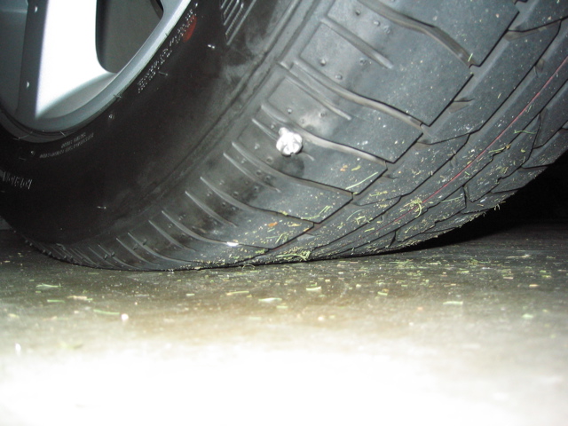

Here is a picture of the damage...

Your gonna have to replace the tire. The "new" stand on flat repair is no repair less than 1 inch from the tires sidewall.
In other words only on the flat part of the tire...

Please Listen To Me! Replace That Tire! The screw is too close the edge. That section of the tire flexes a lot, and if someone repairs it, you stand a chance of a catastrophic blow-out. Replace it please.

The patch plug must be applied from the inside of the tire. I should add that my nail was not as close to the sidewall though. It's hard to say if you should replace or not simply from the pic you posted. Depending on how many miles you have, you may be able to patch it and just finish the life of the tire...fronts typically only last about 10k anyway with all the feathering crap.
