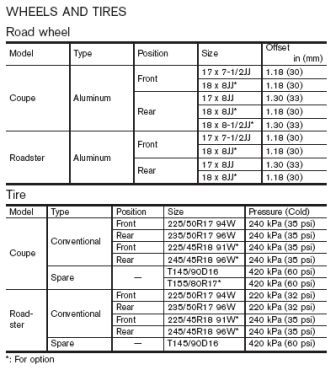

hello, I have a Enthusiast Roadster, and it came with the 17" wheels,
I now want to upgrade to the OEM 18" wheels, what tire size that are factory size suppose to be. I do not want to make my speedometer be off my a few mph. thanks,,,,,remember I'm a newbie.....thanks

Look in the owner's manual, it has lots of info.
Attached Thumbnails NewBie Question....OEM 17" to 18", what OEM tire size?-z-tire-size.jpg

Factory sizes for the 18s are 245/45/18 rear and 225/45/18 for the front....I have an '04 ZR and just put Michelin Pilot Sport AS 255/40/18 rear and 235/45/18 up front...GL2U....Dave p.s. The OEM Bridgestones suck...11,000 miles...:-(
