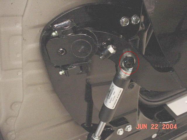

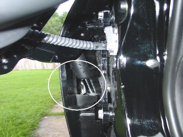

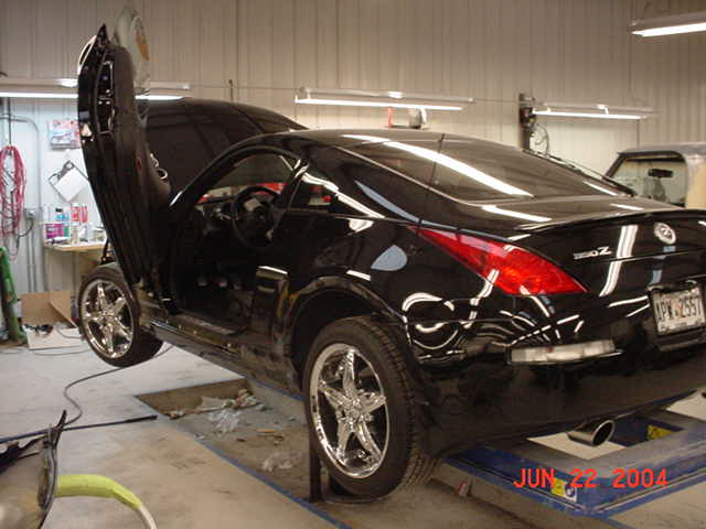

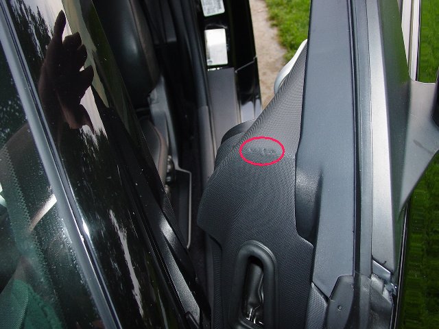

I have had them since 6/2004.
Problems:
- hood, fender, and door lines are not all equal.
- requires occasional adjustment
- gas strut broke once
- inner door panel hits roof pillar if not careful
- inferior door close and seal noise.....not a solid sound when closing the doors.
- structural integrety not as good as stock hinges.
Benefits:
- Wow factor and attention
