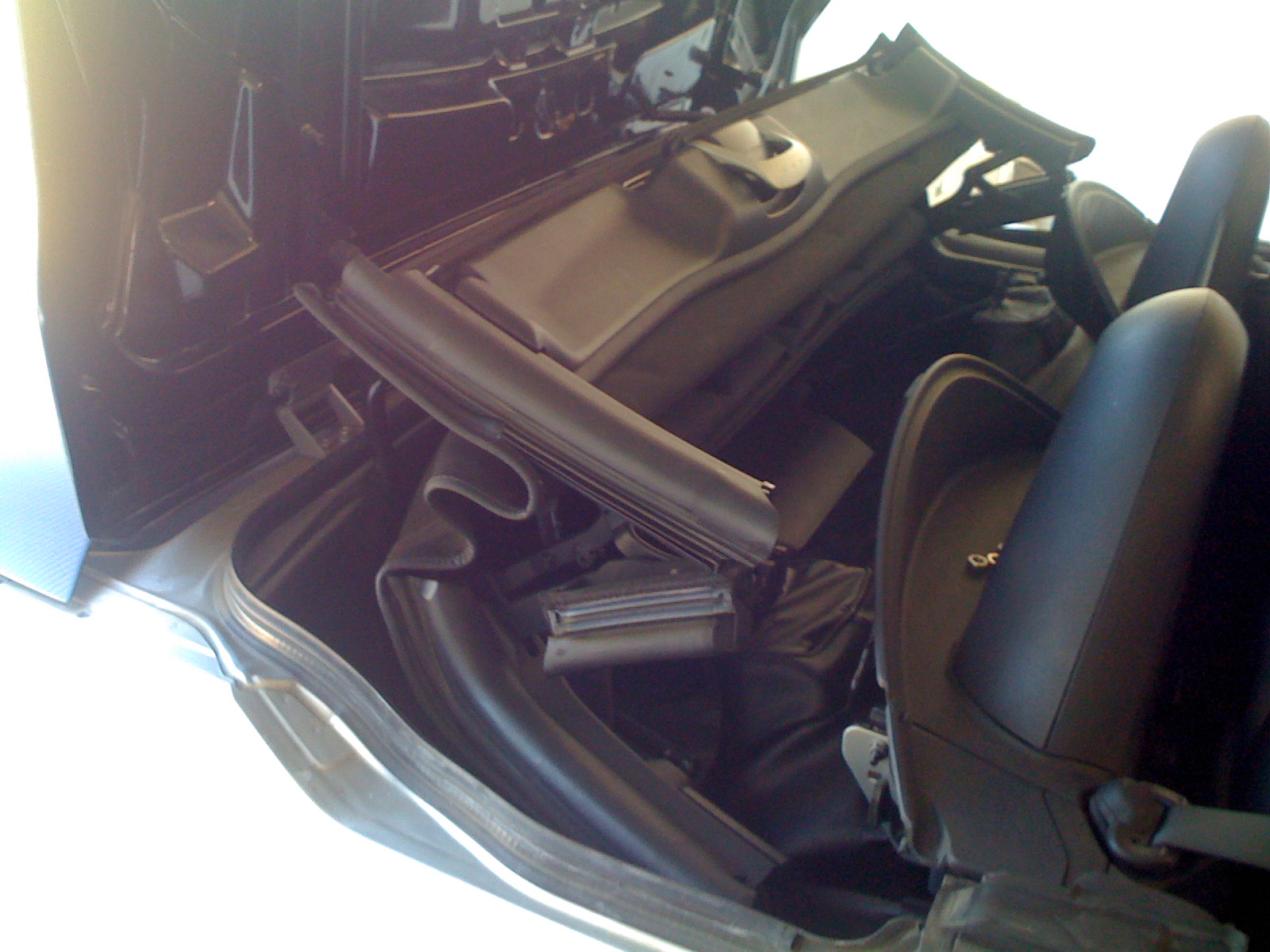

Default looking like this?
After I got rear-ended it started happening to me, but I didn't see anything in the way. I push on it a little and it worked fine for 4-5 days then started again. Is this what its looking like?
Attached Thumbnails Advise needed!!! top only goes down 4/5s of the way-img_0472.jpg

Default yea exactly like that
yea and i tried pushing down on it a little and it worked after making a really loud clicking sound lol but yea that picture makes me want to pull my hair haha
