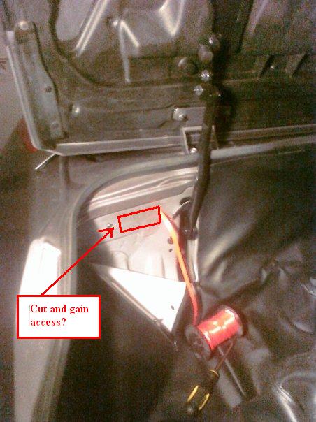

why not cut an access hole here:
Then do a doubler welded reinforcement.
not sure about fixing the extender or its assembly......i would have to be there but it looks like your also on to something there for sure...good luck with it..

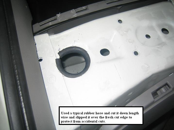

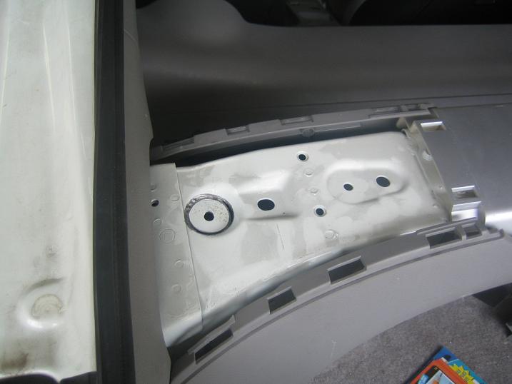

This is what i did with my car - of course i have a coupe Z:
-J

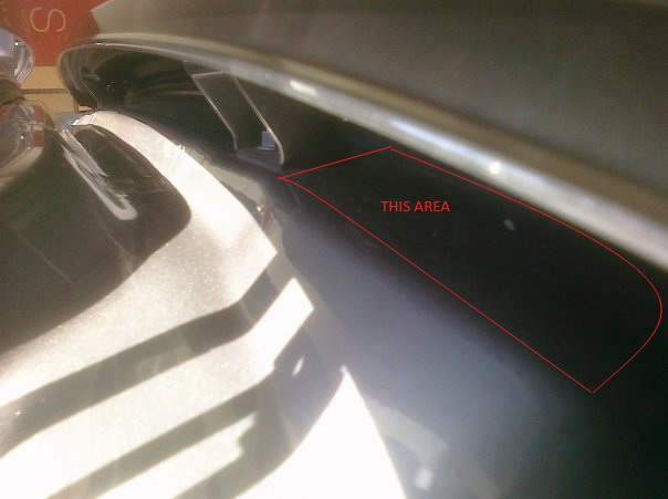

The green area......is that the exterior painted top area......outside body of car?
-J
Old Feb 9, 2010 | 07:27 AM
vtchang's Avatar
vtchang
Posts: 549
From: Virginia
Originally Posted by JasonZ-YA
^ okay, gotcha......
-J
I think I know what you're talking about. But to make sure. The green area is UNDER the red area in the picture.
Old Feb 9, 2010 | 07:31 AM
JasonZ-YA's Avatar
JasonZ-YA
iTrader: (60)
Posts: 11,204
Likes: 32
^ can you take a farther back pic? of where thats at??
can you drill a hole there in the green area/red area to access them?? what covers that area up? is that just the outside of the car?
can you point to where on these pics? http://www.seriouswheels.com/pics-mn...r-1024x768.jpg
http://l.yimg.com/dv/izp/nissan_350z...ther_trunk.jpg
I remember seeing an Options video where the track prep'd Z had extenders poking outof the hatch on a coupe z.......was grommeted and sealed well......I guess the never open the hatch...or take them off to do so..
-J
