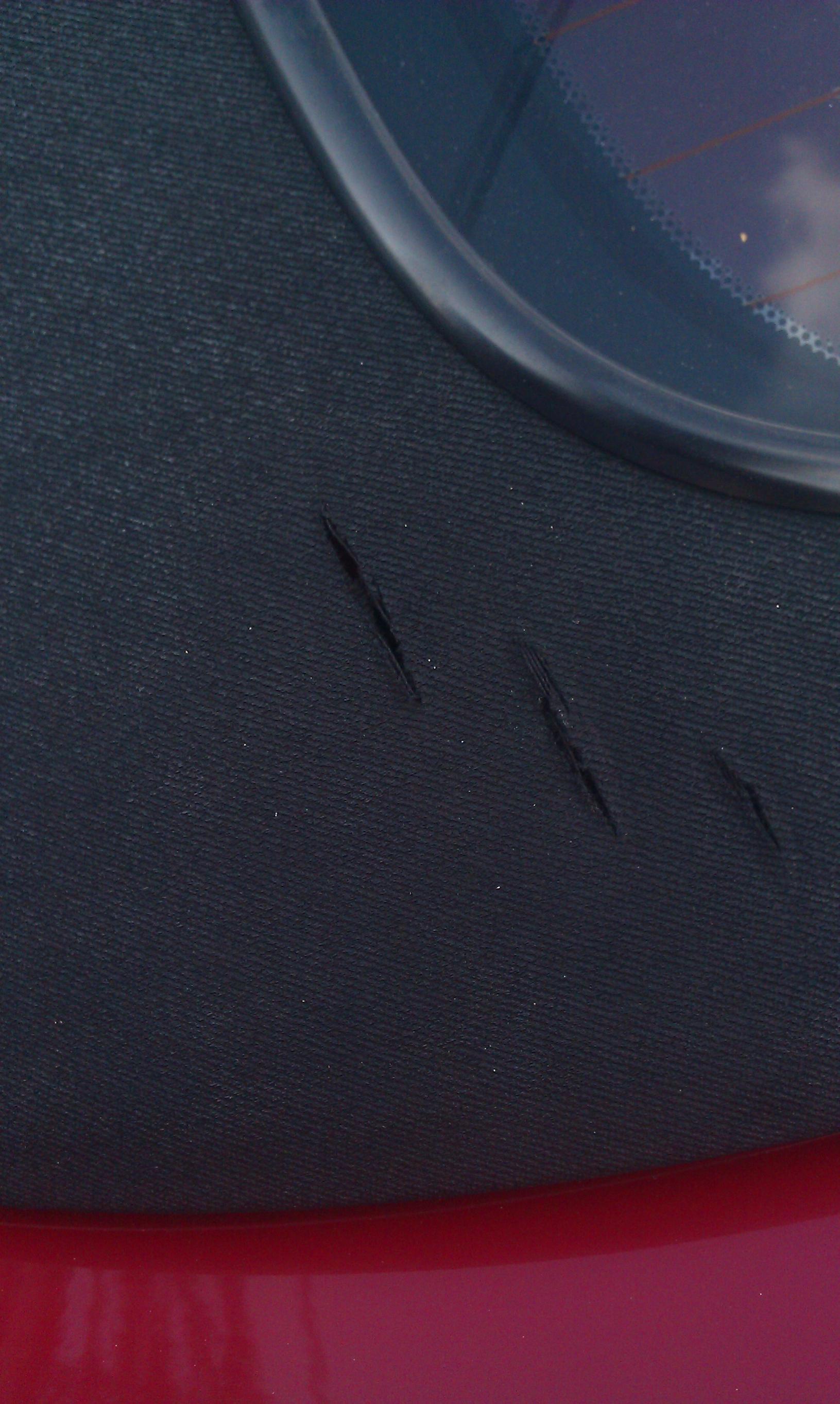

Default Torn 350Z top progression
Attached is a pic with in a one week progression on my top ripping on the drivers side lower window area. I have an appt. Friday 6/17 for them to look over the issue. Kind upset as I just bought the car 2/26/2011. Really upset but the warranty manager said they will take a look... maybe Ill just suck it up and buy a cloth top.

you didn't get this from me but it looks like someone took a razor and hit it three times what an interesting thing to tell the adjuster

Gotta tell you, I've never seen tears like that in that specific spot.
They are so clean. It looks more like something sharp hit the roof 3 times.

That's some Wolverine shit right there.

lol now that's what i would really tell the adjuster wolverine that f'er came out of nowhere and look what he done
