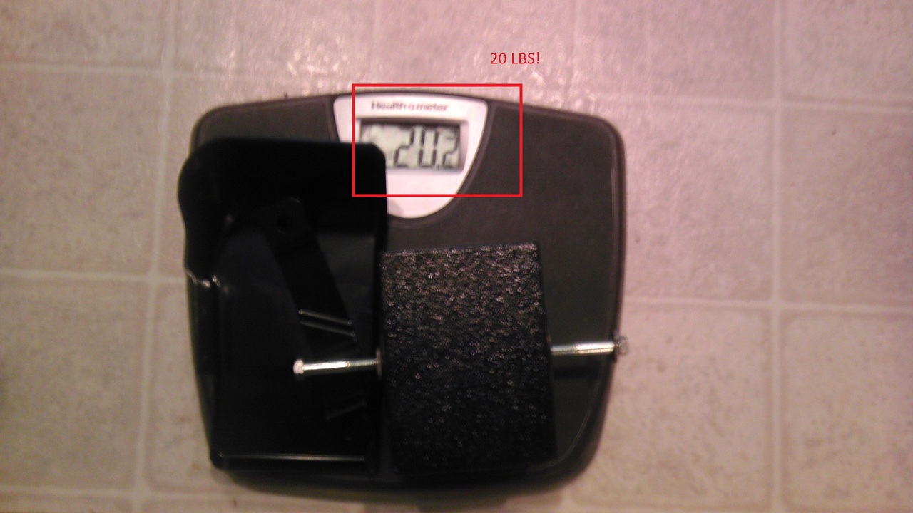

Grand Touring Roadster = 3602 Lbs
My Grand Touring Roadster = 3582 Lbs

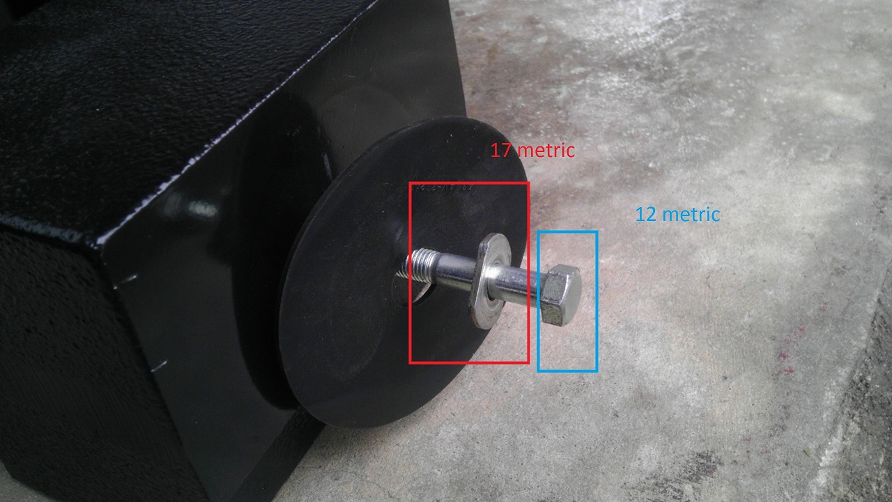

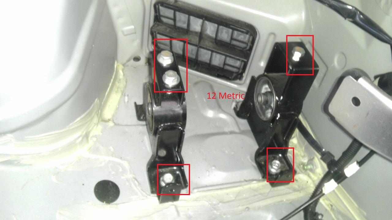

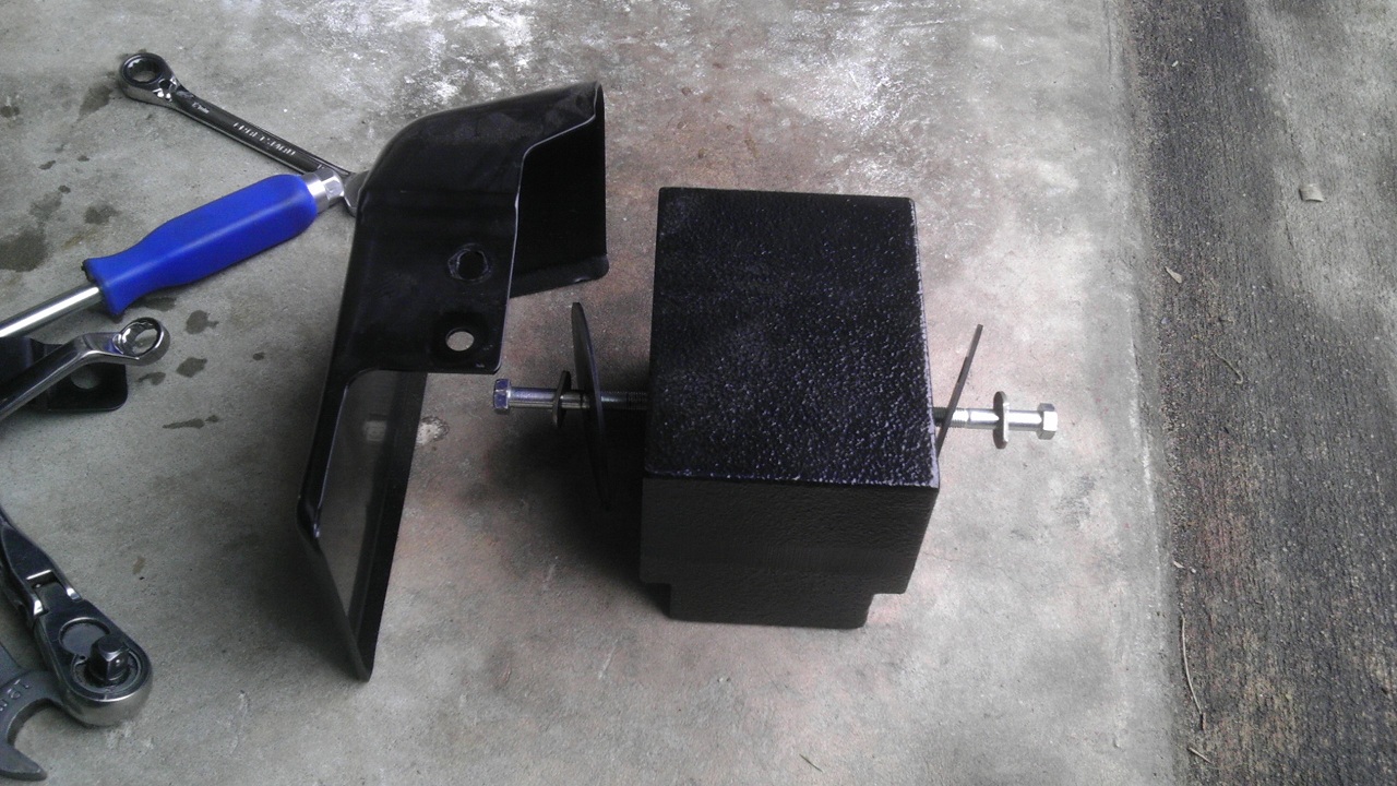

The roadster has two harmonic balancers in the car. One is located on the RIGHT side of the trunk (next to the spare) and the other is located on the LEFT side of the engine bay (next to the oil pan).
I got no money to mod so I took the extra weight out of the trunk to get my fix in.
I'll probably remove the on up front next week.
Attached are pictures of the weight located on the trunk. I labled a few of the bolts to aid in the removal for anybody interested.
Attached Thumbnails Chassis Harmonic Balancers-imag0589.jpg   Chassis Harmonic Balancers-imag0590.jpg   Chassis Harmonic Balancers-imag0591.jpg   Chassis Harmonic Balancers-imag0592.jpg
