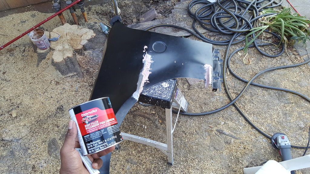

I don't do body work... So I new I'd need a large margin for error.. So I loaded up and just took the time to sand it AAALLLLL down to where I liked it

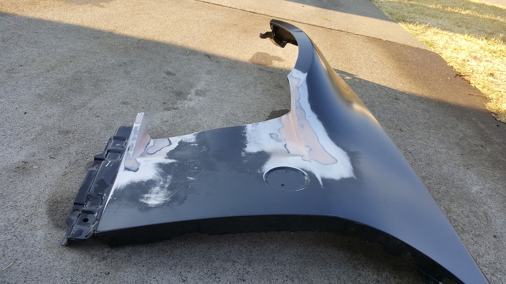

3/4 of the way

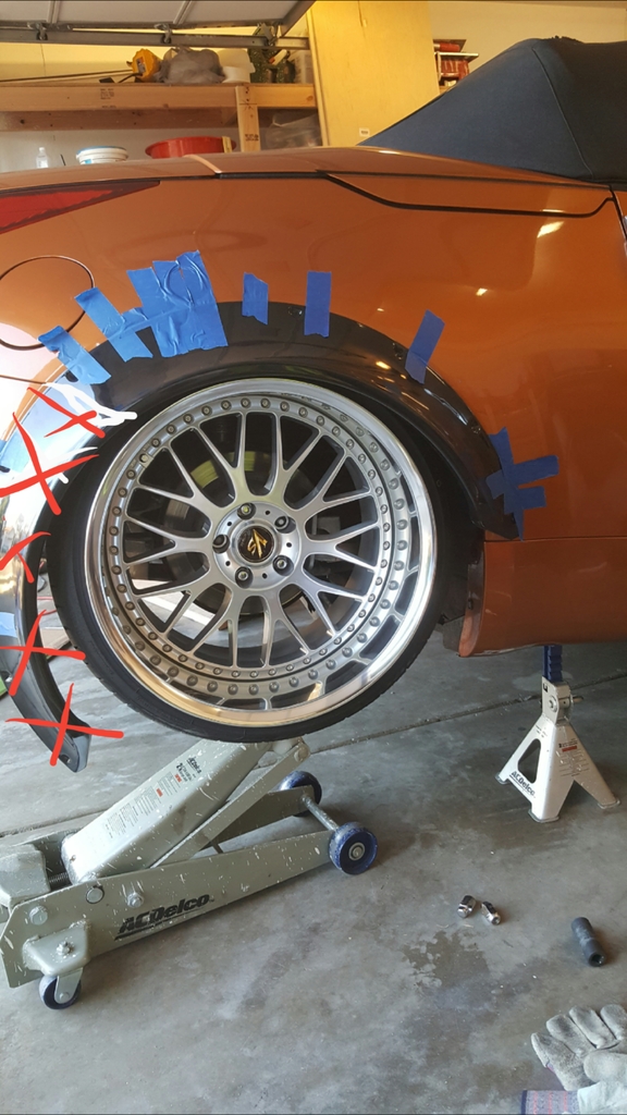

Not too bad

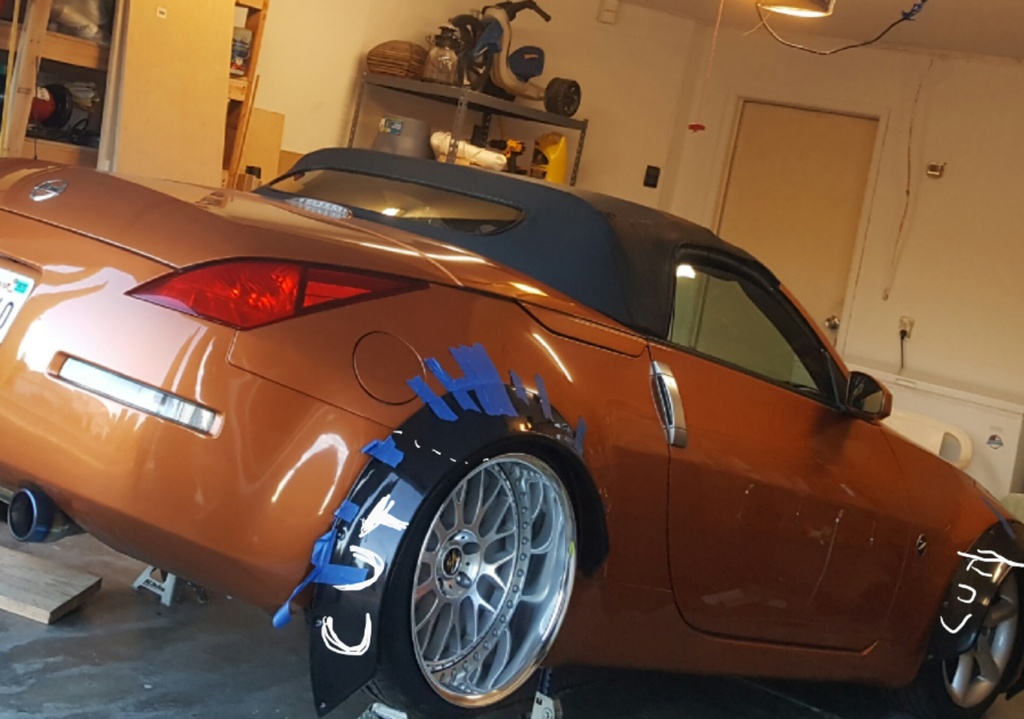

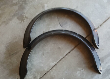

Yesterday (Aug 30 2016)
The overflares arrived.
And they look like they are going to do the trick

Well one of the sets arrived...
The other pair got sent to "Massachusetts"...
But I'm not gonna let that stop the show.
Although I don't want a "rocket bunny" I do like the areo look. I getting the fit I want set and I'll start cutting on Monday.

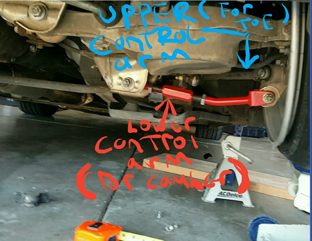

What nizmo is saying is you need to replace your stock spring buckets with aftermarket toe arms (as most people that convert to a true coilover setup in the rear do).
When you were maxing out your camber arms & your wheel/tire started pointing to the right.. That is TOE. To correct that at the extremes that you are attempting, you need aftermarket adjustable toe arms.
These are camber arms:
These are toe arms:
Result:
Hope that cleared things up a little.

Physhin is absolutely correct. That toe arm should help tremendously and probably negated over fenders but it looks like your all in now. However a toe arm will make the driveability much better

The lame part is that I thought this:
The fortunate parts are that
1) without knowing, I've purchased both. I put the Megan rod back on and took the red (s something something) one off... And its where it should be. So its just a matter of taking the spring bucket off and putting the red (Spec-d!, had to go look) camber arm on.
2) I've negated my need for extream camber buy going wide body.
Man..... I feel like I followed a treasure map all the way around the block only to end up 2 feet from where I was originally standing when I started
