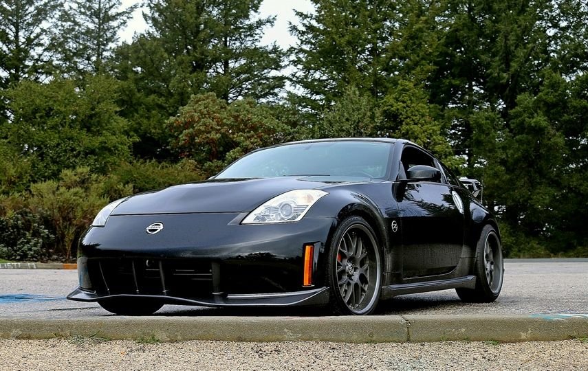

Only tradeoff there is if one goes with 19s, there's going to be a weight hit UNLESS one opts for forged or something using MAT, like RPF1s. Also, tires costs escalate.
Don't get me wrong, I run 19s almost exclusively for the turn-in response because the weight differential between OE and my setups is almost a wash because of the above consideration (forged) and lighter weight tires. Current set-up (Nissan LMGT5) is in the low-mid-40# range per corner (which isn't terrible)...
But be careful, not all forged wheels are created equal.... this set of forged rim/pressure cast center Volks are in the 50# range rears and don't be fooled, the Nismo V3 OEM wheels with Bridgestone S04s are a hefty 55# rear (wheels alone are 29#!)
But my all time favorite setup are 19" LMZ5 Z34 wheels, also shod with Bridgestone S04s. These wheels are a marked improvement over factory issued Z34 Nismo or Sport wheels at a "mere" 20# each, very light for a 19x10. These are also in the low-mid-40# tire/wheel weight range but if I bought lighter tires like my current Toyo Proxes 1s, could probably get them down to straight LOW-40#/corner.
Offset recs are good. but that 275/30-19 tire rec is too short by 0.80" which will almost surely lead to VDC (and possibly TCS) faults. Stick with 35 aspect ratio, 275/35 or 285/35.
