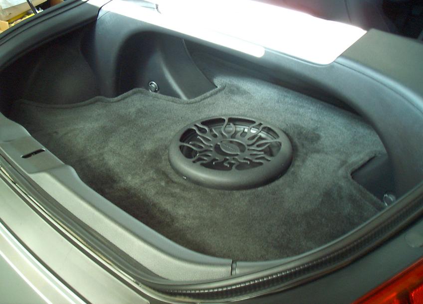

12" MB Quart with new Audiobahn metal grill. Tire well location.

Custom box there?

I've posted pics of the box buildout before. 18" square fiberglass under the false trunk with MDF top and spacer ring. Hardest part was building the box to match the height of the trunk to keep everything stock. Had to cut a hole through the thick mat but the metal grill overlaps and covers really nice. I have an Alpine 350W amp and it sounds fantasic with no rattle and enough acoustic force to blow my hair around. I still have space down in the trunk to store things and the grill is very durable metal if I want to tote things back there.

trn, the problem with sinking it below the false trunk in the back is the height between the floor and the carpet. If you use the forward portion of the spare well to build the box into, you will only have about 6" of height. Considering a fiberglass box bottom will be about 3/8" or so, you will not have enough depth to mount very many 12" subs. When my box was complete, I only had 5.6". I chose an MB Quart Reference 12" sub since it only required 5.5", but I wanted to put a little distance between the magnet and the enclosure bottom/floor so I added a 3/4" MDF ring to the top of the box. That way the sub magnet is about 1" from the bottom. Using the stock carpet and the thick carpet, my sub sticks out less than 1/2" above the trunk/carpet. With the grill it sticks out about 1"
So it is not a matter of whether you want something to sit flush or not, it is the limited space you have to work with back there compared to what you are trying to mount. I've seen some people mount more flush by either choosing a smaller sub (10") with less mounting depth...or modify the fake trunk by proping it up higher and thus creating more space underneath. I didn't want to mess with modifying the trunk liner or carpet so mine is the way it is.
Regarding grills, be careful putting a shallow cover over your sub. The Audiobahn I used is pretty tall, but I can still hit the grill with the woofer cone when I have the sub turned up past about 80% volume with heavy bass music.
BTW, mounting in the spare well to me is the best approach, it seems to let the bass build in the trunk while keeping the strut tower unobstructed to allow air to flow freely from back to front.
