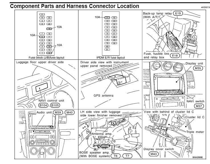

parts and position locator for nav system

Thats great but im not sure how it helps with sattelite radio.
