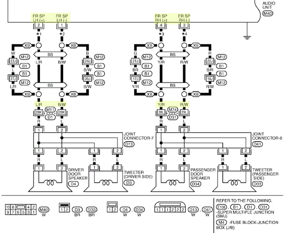

This should help. Bose might be different, I am not sure.
Attached Thumbnails Door speakers blue & red wire which is negative-untitled-1.gif

Red/blue doesnt seem to match the diagram. Weird!
Just disconnect the speaker, take a AA battery, put the positive side of hte battery to one terminal on the speaker and the negative the other. if the speaker moves outward then you have correct polarity and can figure out what wire is which on the car's connector.
