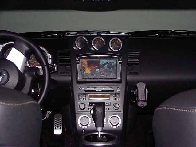

Here is a full frontal shot taken from the back seat... (right!). The picture is zoomed to full size, edge to edge. No loss of picture whatsoever. The fit is most excellent. For copyright purposes, the image on the screen is from Pearl Harbor.
Thanx, Pacco.
The DVD combined with the surround sound is a mindbender!
I put in 4 Inifinity Kappa 63.5's which are 3-way speakers which eliminated the need to deal with the tweeter seperates. I just disabled the factory tweets. The birightness with the kappa is just fine to my ears and I have had many compliments. Although quite acceptable, I would like to have the midrange boosted a smidgeon. I believe this can be accomplished with adjustments on the Kicker 700.5 that I am using and I hope to address that issue sometime in the next week or so.
No problem with fit. Spacers were used to clear the window travel. Be sure to use sound dampener such as dynamat.

Originally posted by pacco
Wow. that display looks awesome!
Can you tell me anout the kappas? I want to go w/ those, did you go w/ the Kappa 60.5cs?
If so how did they fit? the tweeter? the crossover?
Many thanks.

Interface to factory HU went smoothly. Here's what you need to purchase:
Pioneer AVIC90DVD
Pioneer CD-TS36 Voice Guidance Speaker w/ IR Sensor
Pioneer CD-RGB26P Connection Box
FM Modulator
Up to 7" Monitor
The above components yield the following:
Audio for Nav is played through the CD-TS36 and, in my install, does not mute the stereo, if it is playing. I would prefer that it did, however, I can live with manually lowering the volume when the sweet dulcet tones of the Nav lady bark out driving commands.
Audio for DVD is played through the FM Modulator and in my opinion produces excellent sound through the stereo.
Video to many LCD monitors (including Farenheit and Microvision) is enabled with the RGB Connection Box.
A microphone included with the AVIC90DVD is mounted near top of windshield and allows option of Voice Activation or manual Remote Control Unit.
Notch to left of screen is indeed for the separate Monitor IR Control Unit. Use rarely for adjusting the screen - color, brightness, tint, zoom, etc. The notch can be created by using a Dremel tool.
I liked the feature set of Pioneer better than Kenwood. Also, I believe the pricing was better. Also I did not want to deal with finger prints - have that problem with my laptop. The factory HU works extremely well with my aftermarket Nav/DVD and upgraded Infinity/Kicker speaker system.
Final note regarding Monitor. Go with a 7" screen. It will cost a bit more, but, you'll appreciate the larger image (easier to read map) and the better resolution.
Best of luck.
Pioneer AVIC90DVD
FM Modulator
Up to 7" Monitor
Best of luck.

Thanks for the kind words, Megatron.
I did not have to replace the Bose Speakers, however... similar to most "factory" speakers, they were not high enough quality for my ears and I was concerned with blowing the speakers with the increased power of the Kicker amp.
I've not tracked success of the factory AMP upgrade so I don't know how well the TSB corrected the problem. Perhaps others can comment on the post recall stereo performance on the Touring model.
Nav would certainly not be necessary. DVD and a 7" screen should work quite well.
Check out pricing for you components at Etronics.Com. I found them to be highly competitive on price and availability and after sale customer service (important).
Best of luck. Enjoy the ride.
PS - Check out the Pearl Harbor DVD for GREAT! battle scenes and surround sound! It's the maximum utmost!
