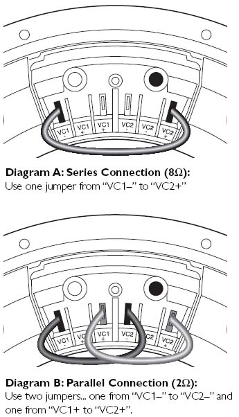

I have a single JL 10W6v2 and planning to power it with an Alpine MRD-M500 amp.
On the subwoofer you can wire it either in series or parallel.
Can someone please explain the advantage of wiring it in series and parallel? what would be the recommended configuration for my setup? thanks.

Parallel 500x1 @ 2ohms.
Series 250x1 @ 4ohms
