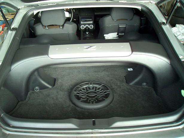

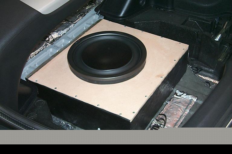

Old Apr 6, 2005 | 01:27 PM
dannichols's Avatar
dannichols
Posts: 866
From: Temecula, California
I built a spare tire FG enclosure from scratch and installed a 12" MB Quart in it. I love it. I get much more bass than when I had a 10" in the strut tower. I think it has to do with the fact more free air space is open in the rear, strut tower enclosures block off the rear (except for 1 1/2" above the strut brace) and cause more rattles IMO because sound waves are trapped.
You have two reasons to soundproof: Vibration dampening and road noise. The first is pretty easy to achieve, the second is difficult, time-consuming, and impossible to get 100% better. Use a Dynamat Extreme type alternative for rattle dampening. I would concentrate on the doors and trunk, but it depends where and what type of setup you end up using. If your going basslink, then a lot in the cubby area. If your going in the rear then trunk, rear wheel wells inside, and back of tire well. The outer door panel already has a dampener from the lower edge till up about 6". I added some Extreme above it. Beyond that I would go for some liquid Spectrum in the outer wheel wells and that's it.

Dan do you have a pic of your subwoofer box/install?

[QUOTE juyz] Dan do you have a pic of your subwoofer box/install?
Attached Thumbnails Need an advice on upgrade from stock system-grill1.jpg   Need an advice on upgrade from stock system-subbx1.jpg
