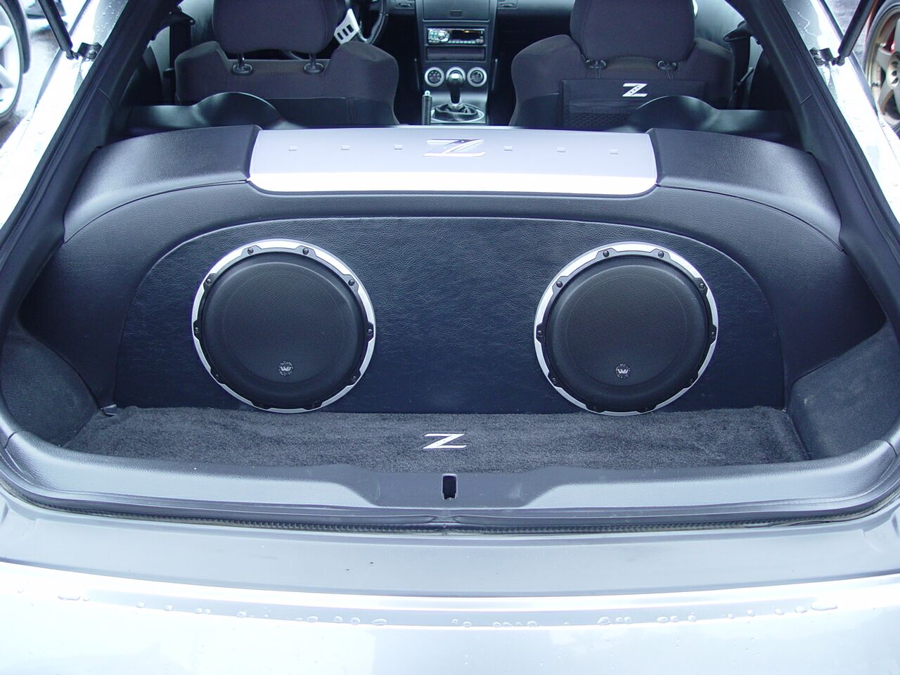

Originally Posted by andyisphat2004
even a box under the strut bar for a jl 10w6 or 10w7 is pretty stealth as long as your windows are tinted
agreed. Here is mine (fiberglass) with a pair of 10w6v2's in it which I am selling by the way. (not advertising that, just mentioning it)

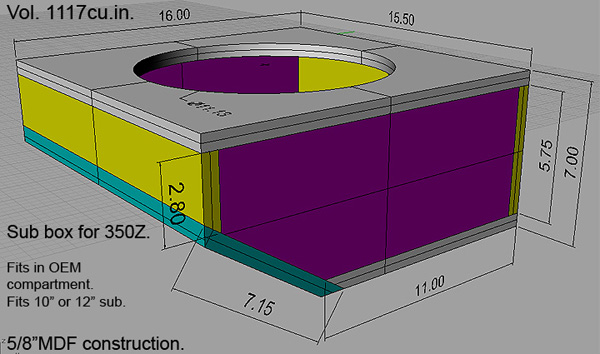

But a box that goes under the strut bar takes up some valuable storage space. If you just want to add a little more bass without trying to win any competitions, the compartment behind the drivers seat should work just fine. When I test drove a Touring model with the Bose system, the bass was actually pretty good. So, putting a speaker back there should work just fine. I would build a custom enclosure and dynomat the heck out of that area to prevent rattles. Here is a template for a box that would fit in that area:
That was actually the first thing I did in my car (still have the dynamat in there) sound was not very good, BASS was flat and response was poor.
