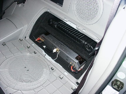

I don't need 3 10's, so I am working on a sealed/fiberglassed enclosure for 1 in a stealth locaion behind the left rear wheel well. I may try to sneak a 10W7 in there, if I have enough cash, and enough mounting depth.
I have heard alot of great things about the JL amps, but don't have any personal experience with them. I would upgrade to the 1000/1 versus the 500/1, the W6's will need some power. You also may want to consider using 2 Gauge power wire, especially if you choose to do a show vehicle. The JL Audio 1000/1 into a 1 ohm bridged laod will require ALOT of current. Anyways, I have always preferred Phoenix Gold for amplifiers, and I used 2 in my system along with a Pioneer Premier Head unit...
See a pic below of my rack, and a comprehensive list of components at the end...pics of my sub enclosure will follow soon.
