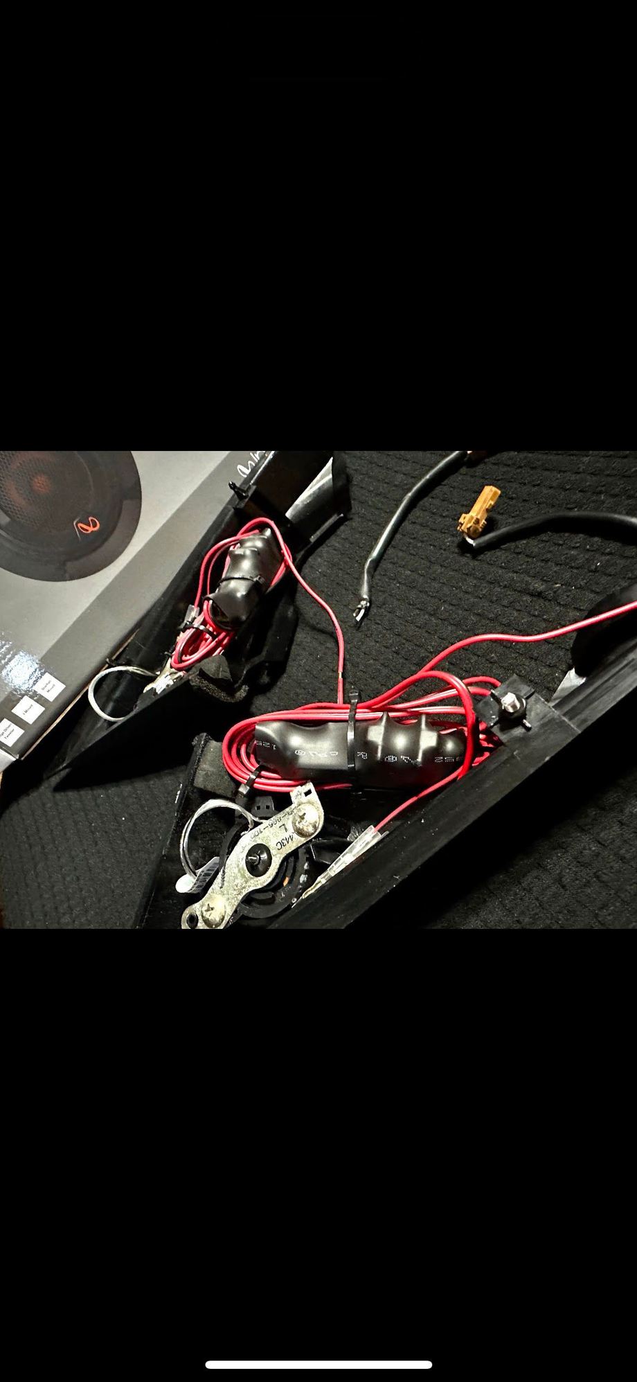

Infinity Tweeters 375tx
18.5 year dead thread
