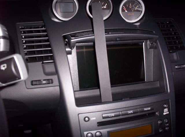

Cut from black rubber wall base trim from Homedepot.
Perfect color match and thickness.
Attached Thumbnails More pics...GPS antenna, Nav. compartment finisher-finisher1.jpg

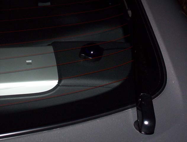

GPS antenna
Attached Thumbnails More pics...GPS antenna, Nav. compartment finisher-antenna2.jpg

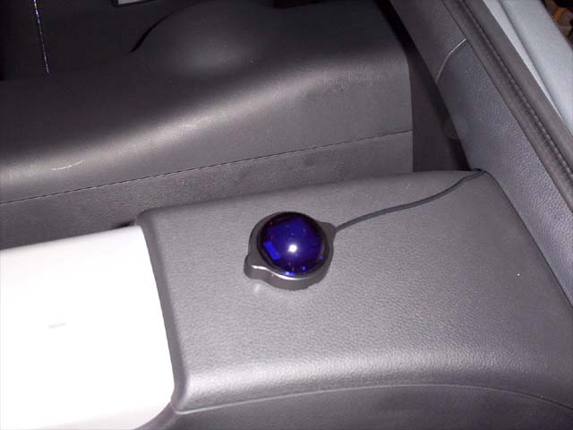

Antenna1
Attached Thumbnails More pics...GPS antenna, Nav. compartment finisher-antenna1.jpg

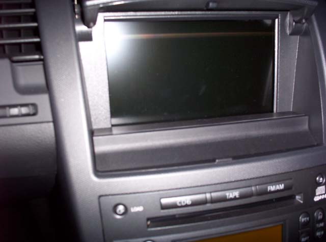

finisher2
Attached Thumbnails More pics...GPS antenna, Nav. compartment finisher-finisher2.jpg

just curious, why not hide the gps antenna under the dash? The factory one works fine there, and jtree007's xm antenna is mounted under the space for the nav screen, on top of his head unit and it works fine too.
Old Feb 17, 2003 | 07:15 PM
rouxeny's Avatar
rouxeny
Posts: 2,774
From: Honolulu
I think it should be possible to mount the GPS antenna or a XM one in the stock GPS location. It's located on the front dash, behind the primary instrument cluster. GPS works through plastic with no problem.
Old Feb 18, 2003 | 04:43 AM
abz123's Avatar
abz123
Posts: 722
From: Central time zone
May have to check that out....
