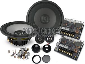

Originally Posted by BLKroadster
Dam I just bought some MB Quart Q@218.61. I wonder do they fit. Im selling if I need pods to make it fit. Wish I read this thread befor hand.
Maybe you are lucky with MBQ. If they are anything like the MBQ PCEs they have a small magnet. Yes they are pretty deep, but the small magnet keeps them from hitting the lowered window. I was able to mount the MBQs using 1" spacers.
But I didn't like the MBQs, they sounded too shrilly and bright for me. Sold them .
Check out the MBQ series. You see what I mean about the magnet, it has a small diameter, you can get by with a smaller spacer.
Unless you got the signature series. I believe they are a larger magnet.
