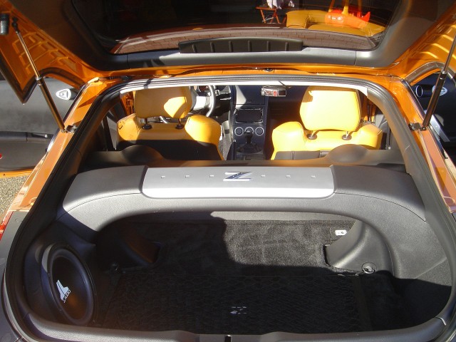

What is the Valentine one doing at low part of this hatch?
Attached Thumbnails 350z subwoofer upgrade questions (volume etc)-350z_sidebox01.jpg
