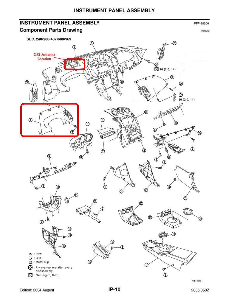

I used the GPS antenna location under the driver's side upper dash cover. Works great. See Attached.
Attached Thumbnails Sirius Satalite Antenna Mount Locations?-350zinstpanelgps.jpg

I already have factory navigation in addition to the DDX. Is there room to fit both antennae?
