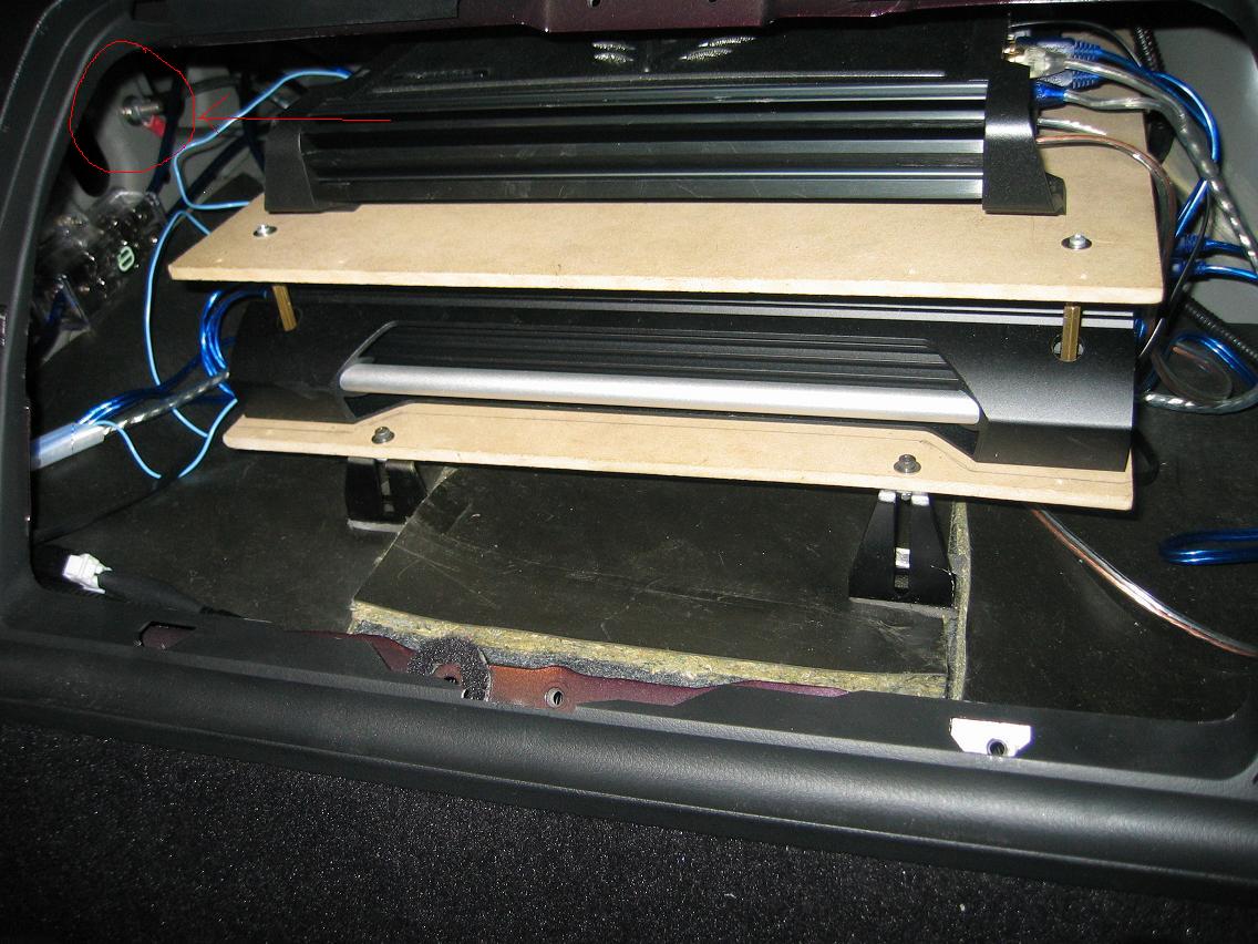

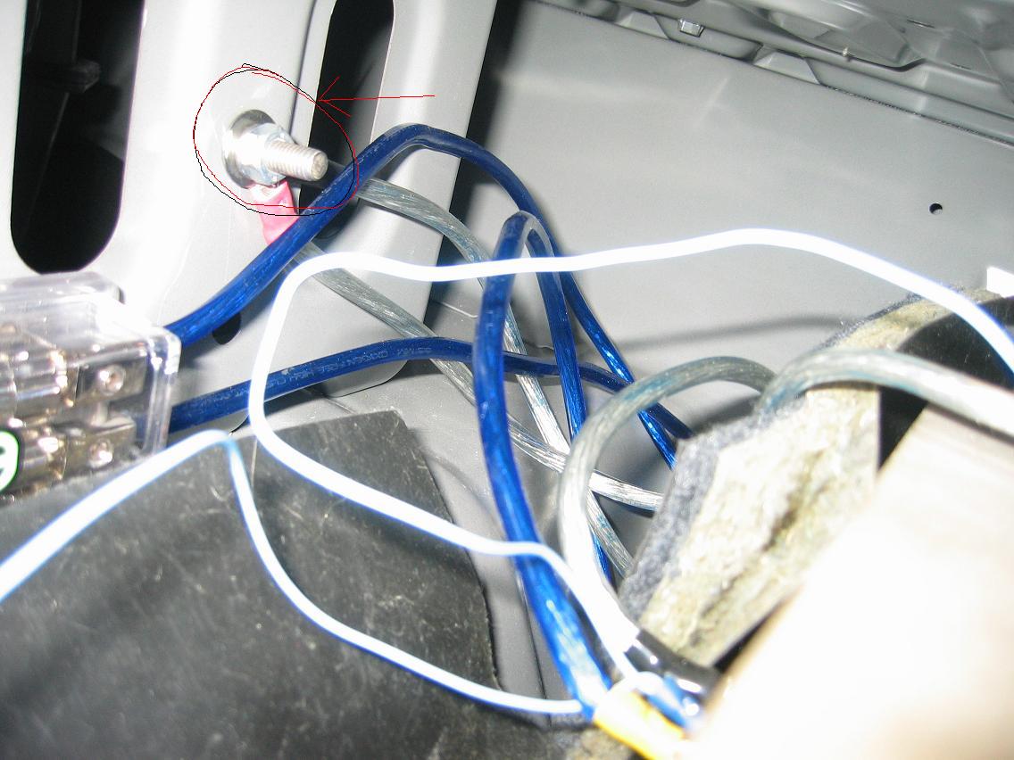

For me, ground for the amps is bolted to a screw in the cubby, you will see it once you look in there, if I remembered correctly you don't even need to drill, just put a bolt and a nut in the hole and that should be fine, or, the bolt and nut was already there? I have a bad memory sometimes, but if it's not already there you can easily supply your own.
I don't even remember having to sand down an area for the ground, but if yours is painted in that area just sand it down to bare metal.
Only thing is, you should tune your amp BEFORE mounting there because the cubby is not always the easiest place to tune your amp after it's fixed in there.
I can try to take a pic for you if it helps, but since I don't drive the Z to work and it's already dark when I get home, I will try to take one tonight and see if it would come out clear.

And understand that the gas tank is mounted under that area ... and if you put a hole in it that would be a bad thing.
(it's been done by people here)
I mounted mine to the lower front edge where the subwoofer mounts and to the rear tab where the stock luggage cubby would have been.

Originally Posted by paul1994
Thanks, I appreciate if you could do that..
Here's the shots of the grounds. It's not as Fancy as the above picture
Attached Thumbnails Help with Amp Install-img_1548.jpg   Help with Amp Install-img_1550.jpg

That's about there my ground ended up too.
Thread rod is fancy?
lol, had to use thread rods since I got two different brands, a Kicker ZX300.1 on top and Phoenix Gold R804 below. I should have kept the brands consistant so it look better.
