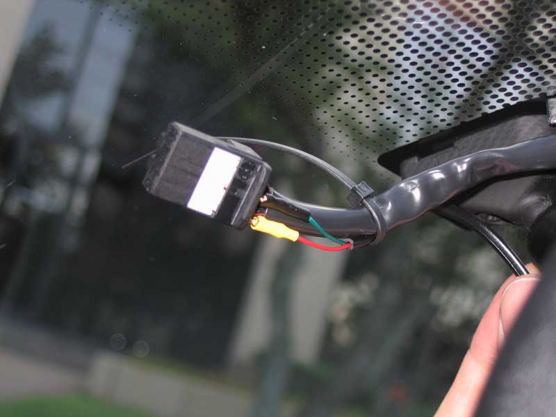

Yea.. make sure the invisicord pin is making contact with the wire inside the power plug (metal). Here's a photo, you can't see the metal-to-metal contact here, but you can see how far in I stuck the pins.
