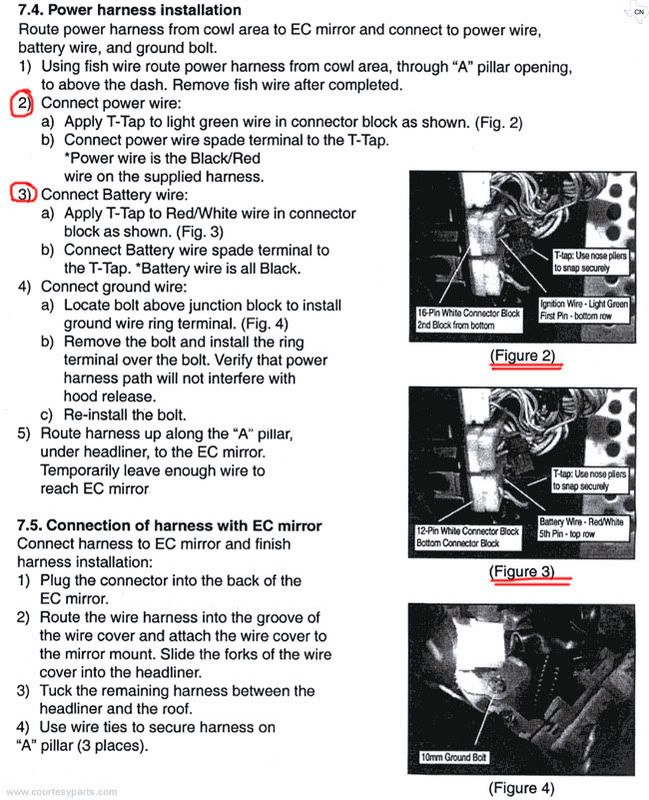

I'm having some difficulties following the instruction for the Homelink/Compass mirror for a base. I have ran all the wiring but just need help on the physical wiring itself.
I need to place T-Taps in the power line (light green) and battery line (red/white). According to the instruction, there should be 2 white connector blocks ontop of each other. But I am have troubling locating these connectors.
This is what I found:
Or are these the right connectors (above the fuses):
THX

I have an 06 base model and am having a hard time finding the red/white battery wire. Help?
