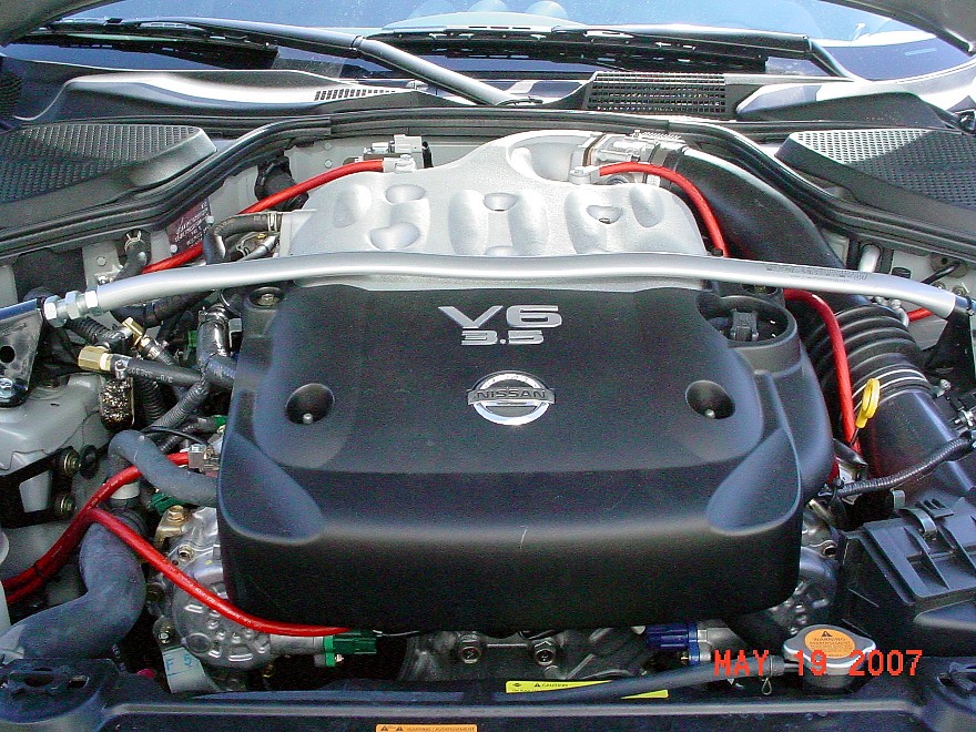

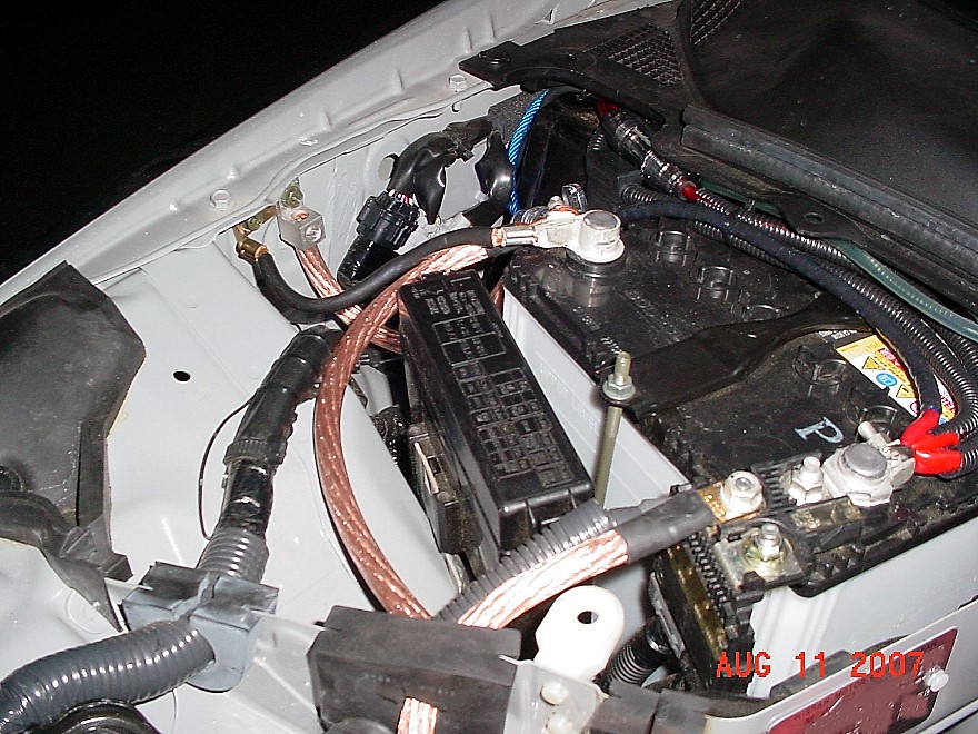

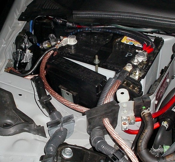

Old Aug 24, 2007 | 08:12 AM
gothchick's Avatar
gothchick
Posts: 3,300
From: ATL
Originally Posted by Seel
This is good information. Now just have to find pictures for the Z. Thanks
Sure, here's a thread/ pics for doing the Big Three on a Z.
https://my350z.com/forum/showpost.ph...6&postcount=29
Attached Thumbnails lights flickering with new setup-dsc02016-1-.jpg   lights flickering with new setup-dsc02019-1-.jpg   lights flickering with new setup-dsc02021-1-.jpg   lights flickering with new setup-dsc02018-1-.jpg   lights flickering with new setup-dsc01948-2-.jpg
