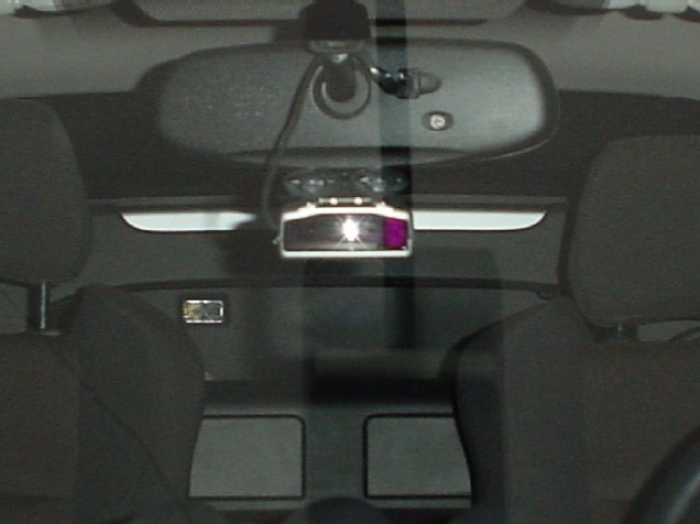

So I'm a girl who was afraid to try this on my own in fear of fu**ing something up - and I'm glad I was. I ordered the V1 Thursday, and got it yesterday (since I'm here in the city), and went up the street to get drake3 to install for me today.
He cut short the RJ-11 and tapped into and soldered it to the auto-dimming mirrors. I just sat and watched Well, I DID hold the wires while he was soldering them LoL.
Thanks drake. It works for me!

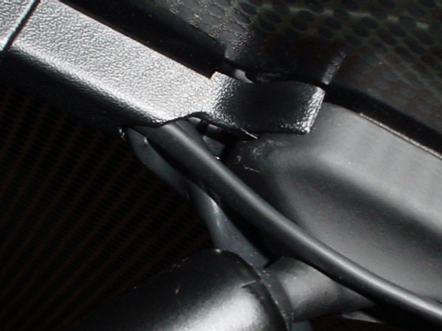

Looks good. I used the same concept but decided to hide the wire "tap" behind the factory telescopic trim piece. I found this to give the install an overall cleaner and more OEM look.

Default RADAR Detector install

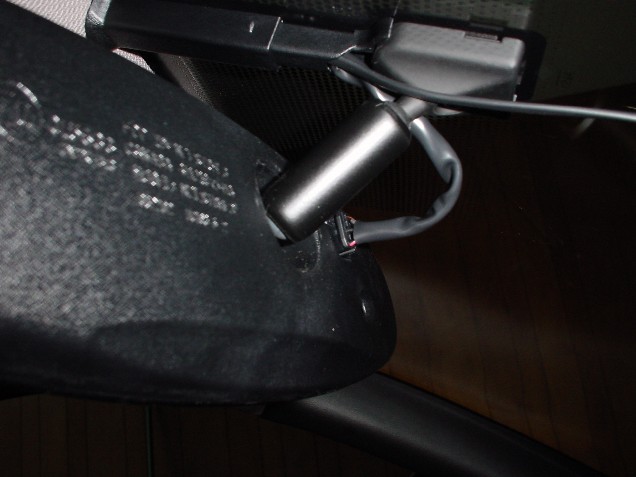

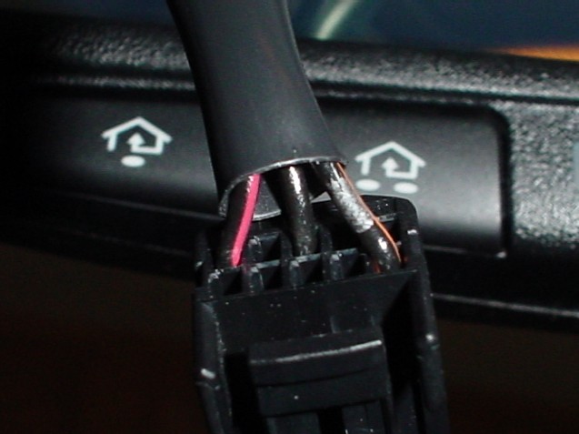

Default which wires
I haven't even looked yet, as I havent got my V1 yet, but for when I do, which wires are + / -
Thanks
Old May 18, 2003 | 12:34 PM
done12many2's Avatar
done12many2
iTrader: (33)
Posts: 616
From: North Carolina
The wire on the far left (Black w/ Red stripe) is the 12 Volt switched. The middle wire (Solid Black) is the ground.
