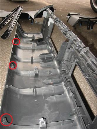

I am having a lot of problems getting the rear speaker panel to fix back into place properly. Has anyone else had this problem?
I can get the 3 snaps on the top snapped pretty easily but the problem is getting the edge in the rear to fit flush. The little plastic tabs I have circled keep bending and don't want to go behind the panel they meet up with.

Push the panel back as far as you can and bang with the palm of your hand where the clips are downward so that they finally get all the way down.
Before you do this also just make sure that you've aligned the panel back properly- make sure you aren't forcing it to fit when the alignment is off.
Some speakers come out farther than the stockers, which can make the speaker grill covers bulge out. Your speakers may be rubbing against these before the cover hits the clips... see if you can find the spot where the contact is.
