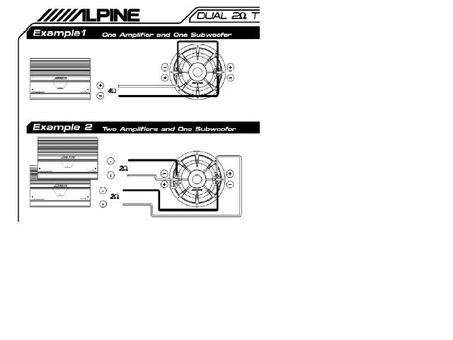

here's a picture of a 2 ohm dual coil:

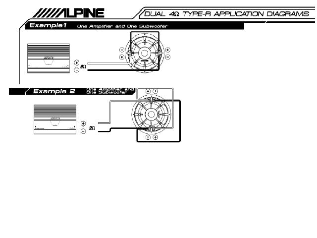

here is a picture of a 4 ohm dual coil:
