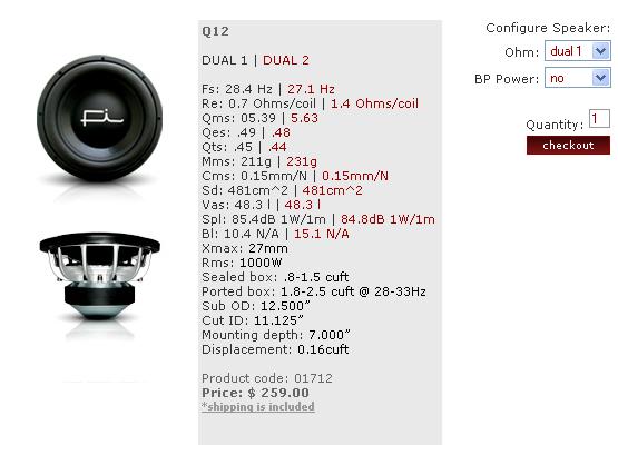

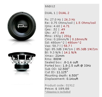

Originally Posted by vo7848
I'm really leaning towards the SSD12 model in the attachment below. How you feel about the options it comes with in the drop down menus?
Example:
1. Flatwind Coil
2. Copper Coil
3. BP power
https://ssl.perfora.net/www.ficaraud...iew.shopscript
Before purchasing this sub, I decided to have a look at the Q12 again. Looking at the specs on both, I can't see why the Q12 would cost $80.00 more than the SSD12. Is there something I'm missing? The SSD12 seems to deliver better specs with lower power requirements.
Attached Thumbnails Opinions on the Fosgate P3 series subwoofers-a7.jpg   Opinions on the Fosgate P3 series subwoofers-a2.jpg

  #92
HondaKiller's Avatar
HondaKiller
Posts: 1,140
the more expensive speaker will provide a cleaner low end frequency note. The difference is minimal on paper, but in the real world there is a larger seperation. The coil on the speaker runs at a lower ohm than the less expensive one. Meaning, if you can get your amp to drop down to 1ohm which is the goal for most bass junkies the speaker will put less strain on the amp. (minimal difference)
The main difference i see between the specs is the SSD12 looks like it would do better in a sealed box compared to the Q12 which has a wide range inside a ported box. The Q12 has a .5" larger mounting depth which consists probably of a larger magnet.
Over and above, both of them will work just fine, probably sound damn similar to someone pushing 500-800 watts to them, but start getting over 2000 watts and the speakers will show their differences.

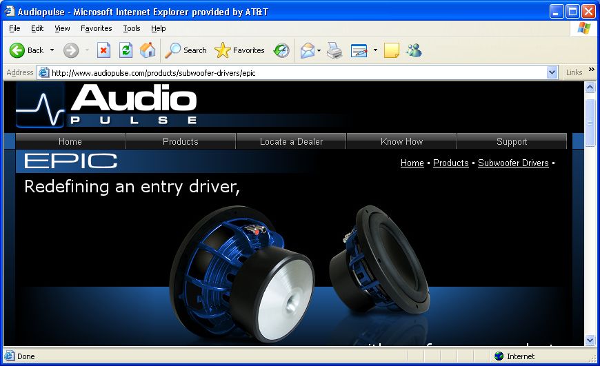

Originally Posted by StreetOC192
For more sound and FLAIR (since you show your car) an impressive sub that works with your enclosure would be the Audiopulse Revo (Audiopulse is the old TC Sounds). This sub is more for SPL than SQ, but it will kick some butt and it looks good doing it. but I don't know of any authorized dealers....you'de have to call and locate one.
Linky:
http://www.audiopulse.com/products/s...r-drivers/revo
Hope that helps.
I reviewed this site again. Since I'm using my orginal enclosure now, the Epic 12" looks like another good option besides the FI SSD12. It's a bit more pricey @ $299.00, but never the less seems to have all the specs my enclosure requires.
http://www.audiopulse.com/products/s...r-drivers/epic
I was always a big fan of TC Sounds subs. I feel you get a lot of driver for your money with them. I'm actually trying to plan out a 3-way front stage around their 6.5" woofer.
Do you have a dealer near you or have you found an online store for Audiopulse?
Besides the specs being pretty much where I need them, I like the driver appearance as well. The "flair" factor will go well for my show application, at least more so than my other choices. This was another reason I had went with the Fosgate T1 for my orginal sub. It matches the car perfectly. I compared the Epic sub to the T1 also. On paper, the Epic appears to be a better output speaker. Mounted depth is perfect @ 6.21" also.
There website link doesn't work. It list a # to call though.

I ended up biting the bullet on the FI Q12. I'm going to add another baffle board to the top of my current enclosure to raise the mounting depth, so I can clear the 7" requirement. The RF P8002 amp I have has a readily available 800watts RMS @ 4ohms(bridged). I'm pretty excited to see what this bad boy is going to do. I'm sure it'll hit harder than my previous RF T1 12" sub.
