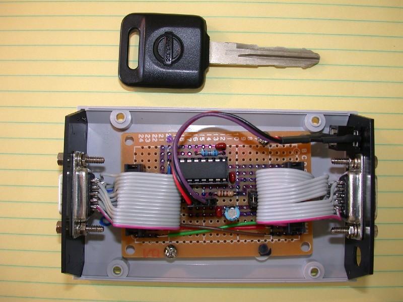

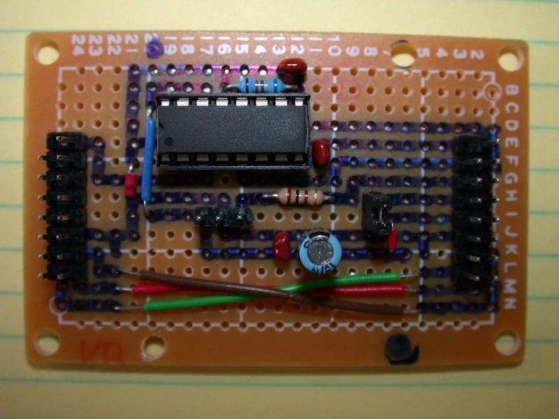

Here is the $43 device you need to build to get your $240 GEX to work:
NOTE: The schematic is newer than the photos, and includes parts not shown in the photos.
Pv

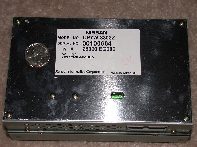

I spoke with a rep from AV electric. Their system does work for the 350Z, but you have to cut 4 wires and attach them to your system, versus 1 wire on the infinity. However, they are looking for a way to do a plug & play option directly to the monitor with a pre fabricated connector. The trick is they need to get a picture of the back of the screen to see where and what they need to build.
Has anyone seen the back of the screen, or been in that area of the car. It's great to have a solution, but it would be nice to avoid cutting wires.

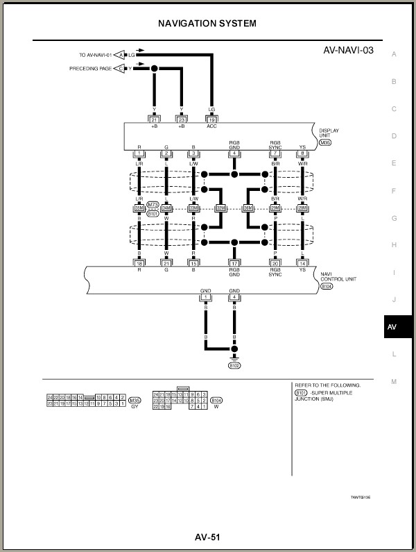

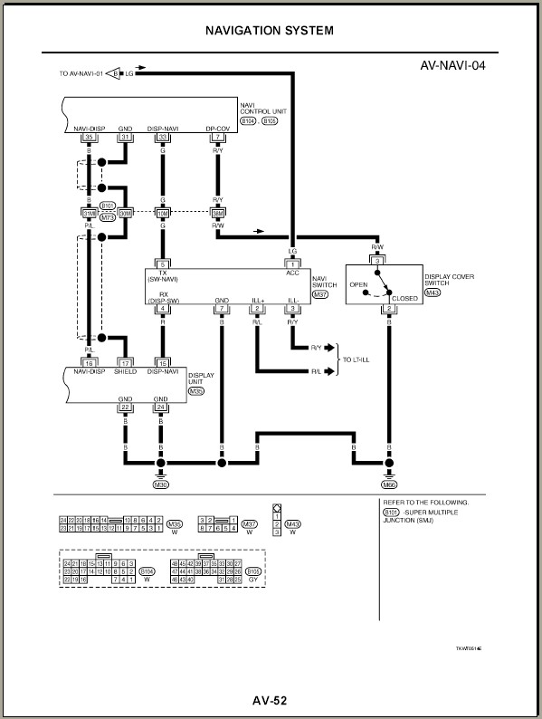

You mean like this?:
Actually, that is a bad shot, but the connector (M35 in the diagram link below) is fairly standard for Nissan.
I've talked with some Infiniti owners, and their wiring and connectors are identical to The Z.
Here's the Z's wiring diagram:
http://www.swooby.com/z/navpc/pics/navi%203.jpg
http://www.swooby.com/z/navpc/pics/navi%204.jpg
And here's the Infinity G35:
http://www.geocities.com/wonderer369/G35Nav.html
Click on "Navigation RGB+Sync Diagram"
(stupid GeoCities won't let me link directly to the JPG)
All of the connectors look the same, so I cannot think of a reason why AV Electric would say the 350Z is different than the G35.

Yes, we are still waiting for the picture of the back of the Nav Screen and the Nav DVDROM from one of the 350Z owner. Of course if the wires are cut than the warranty is voided. The plug&play release time frame depends on how soon we can get the information needed and match up with the right connector. The NavTV-Tuner system has been tested working in a 350Z.
We tried to go to the website you mentioned but can't see any posting about the pictures. Do you have to be a member or login password to visit the www.my350z.com? We went into the Audio&Video section. Please let us know andf you can also contact us at 770/418-1793.
