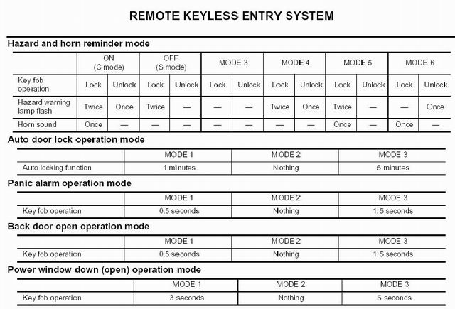

To change the mode (other than the honk/no honk factory set option) you'll have to get the dealer to set the mode.
I attached an image that shows all of the modes available.

Old Aug 29, 2003 | 05:00 PM
MacGuru's Avatar
MacGuru
Posts: 662
From: NYC
Is MODE 3 the default. It seems like that's the reaction times. I'd like to go to MODE 1. -m
Old Aug 29, 2003 | 10:40 PM
grutter's Avatar
grutter
Posts: 179
From: Matthews, NC
I believe each option has its own mode setting.
Factory Default for lock/unlock (Remote Keyless Entry Hazard and Horn Reminder) is Mode C / Mode S.
Old Aug 29, 2003 | 11:20 PM
AmyCroft's Avatar
AmyCroft
Posts: 1,737
From: Southern California
Default Thanks Grutter
Thanks Grutter..
I like the options for Blink Twice for Lock Once for Unlock and Auto Lock..
I'll get my Nissan Service manager to set it on it's next P.M.
Cheers Amy -
