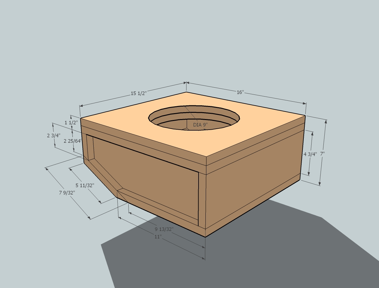

Old Apr 8, 2010 | 10:20 PM
Kwame's Avatar
Kwame
iTrader: (78)
Posts: 5,219
Likes: 19
From: New York
Originally Posted by Spike100
Many members here have asked how to do this. When you create this solution, please post the details. When you do this, you will be the next star on my350z.com.
--Spike
I kept this on my computer from an old thread back in the days when I was a youngin' around these parts. I haven't tried this myself but I know others back in the day have used it with some success.
Old Apr 9, 2010 | 12:40 PM
Spike100's Avatar
Spike100
Posts: 7,337
Likes: 204
From: Edina, Minnesota
^^ Wow!! Great post.
You show the measurements needed for the project, and a great 3D drawing so they are very understandable.
--Spike

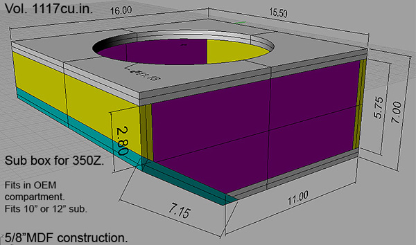

Old Apr 11, 2010 | 07:54 PM
JMSpeed's Avatar
JMSpeed
Joined: Apr 2009
Posts: 243
From: Tampa
How tight is that supposed to fit with regard to the angled boards?
Looks very good by the way. I've re-created yours in my 3D program hoping the measurements are fairly accurate. I only doubled the sub face and recessed the side walls for less volume and more mobility.

Old Apr 11, 2010 | 08:23 PM
Kwame's Avatar
Kwame
iTrader: (78)
Posts: 5,219
Likes: 19
From: New York
Can you rephrase your initial question? I'd like to make an attempt at answering but I'm having difficulty understanding what it is exactly you are asking.
Old Apr 12, 2010 | 04:05 AM
JMSpeed's Avatar
JMSpeed
Joined: Apr 2009
Posts: 243
From: Tampa
Is the angle of the boards on the drawing flush with the body once it is in cubby? The 7.15 piece.
Old Apr 21, 2010 | 06:01 PM
Kwame's Avatar
Kwame
iTrader: (78)
Posts: 5,219
Likes: 19
From: New York
I've never built this exact box but it looks like one or two of the guys in this thread have...
https://my350z.com/forum/audio-and-v...-location.html
Old Apr 26, 2010 | 03:22 AM
JMSpeed's Avatar
JMSpeed
Joined: Apr 2009
Posts: 243
From: Tampa
Thank you very much
