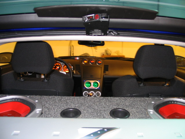

Can u post a pic of ur mounting position, I notice mine would set off radar alert if I take a flashlight and point it directly at my new auto dim rear view mirror. Also since I mainly drive around suburb which set off the detector every 1 min since we got shopping mall every block around here I just mute the radar detector entirely and put the conceal display infront of the windshield to alert me.

Jor. . I will get some clips of my positioning this afternoon.
