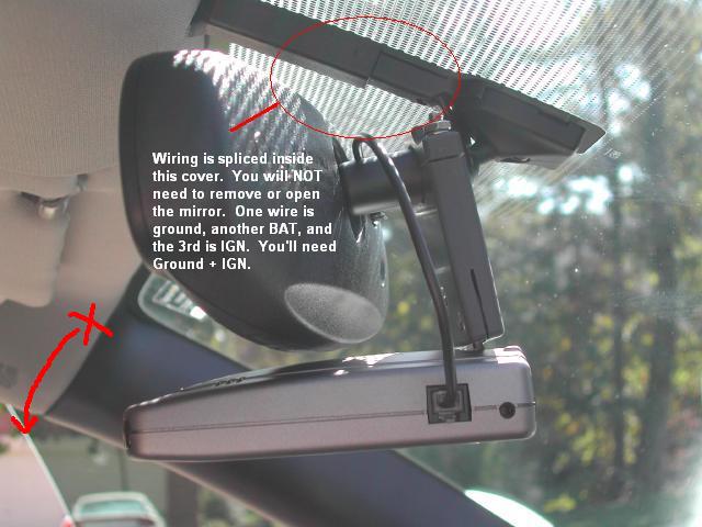

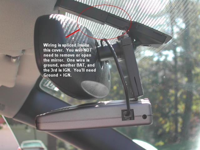

I originally had my Passport wired to the fusebox, and re-wired it to use the rear-view mirror when the connection at the fuse come loose. Stripping the wire behind the leg of a fuse is not the best way to wire your vehicle.... It can come loose, and too easy to connect to the unfused side of the circuit. Properly done, hooking to the mirror leads is fast, very clean, and safer. Sorry I don't have a pic just showing the wiring.. but the job can be done in a few minutes, and does not require you to open the mirror.

The splices are under the plastic cover. I'll try to get a better pic.
I skinned the insulation, soldered the connections, and taped. All hidden under the plastic cover.

From: Zainoland
Also, I was confused by this pic. Do you just have tint on the front of your side window or is this just strange lighting in your pic? (red arrow)
That IS wierd... and I never noticed it in my own pic! Gotta be the lighting... Trust me... my windows are tinted all the way !

On the tint confusion..... I bet Grutter had his driver's side door open, and that that is just the edge of the glass. That's what it looks like to me.

Ahhh, the mystery is solved! That's so obvious now that you mention it but I just wasn't seeing it before your post. YOU DA MAN BriA5!
