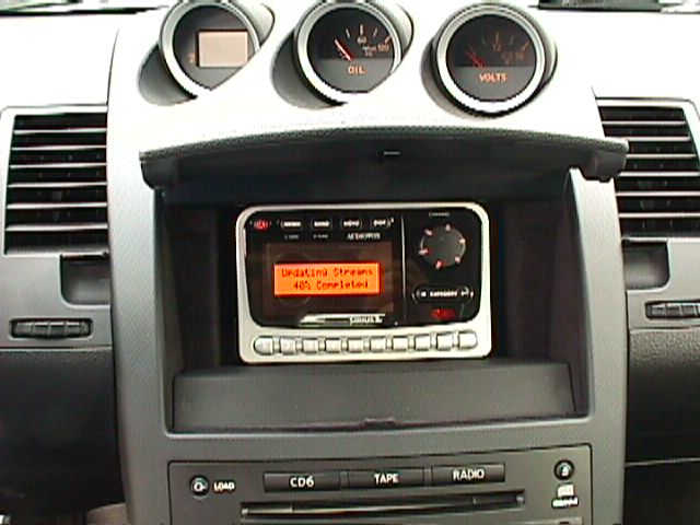

Here is my Sirius with the Audiovox in the nav compartment. I had it installed at a car audio shop.

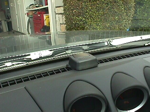

Here is a pic of the antenna on top of the dash. It might not be the best place for reception but on the roadster that's the only place I can find to install it. The reception cuts out in some locations. Maybe just being in certain parts of L.A. Same problems with my cell receptions too. Good luck.

Looks good, i like how the antenna is kind of hidden.
wmchew,
How were they able to put the unit in there without a cradle?
Old Jun 21, 2004 | 07:37 AM
wmchew's Avatar
wmchew
Posts: 115
From: Northridge, CA
Originally posted by ZBoater
wmchew,
The cradle is behind the unit. It just fits.
