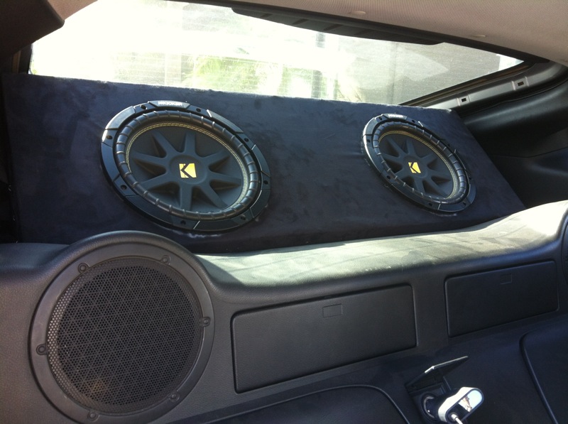

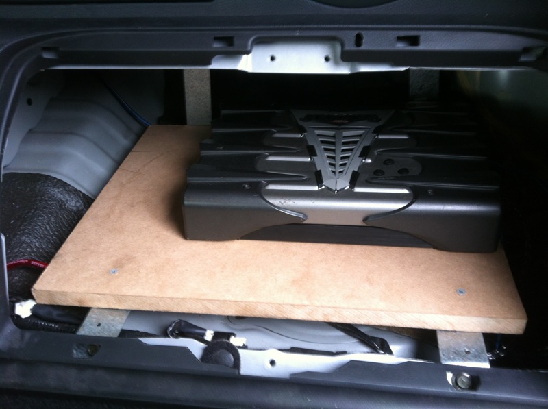

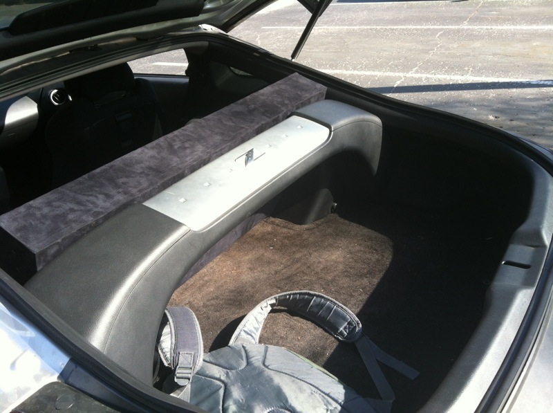

i added some pics this is my set up. it is a 200 RMS Kicker amp, 2 150 RMS each Kicker Comps. i have almost my full trunk avaliable and with the subs there it acts as a nice display of the speakers. my box size is 2 cubic feet, yours only needs to be half that, and with a quick disconnect on the box you could remove it quickly and still have the amp out of the way.
